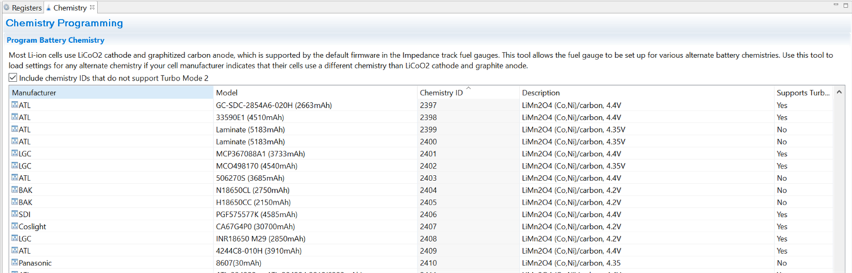

I'm having a 3S3P battery that the original learning cycle was successful. However, this battery will be used for 10W, 20W, and 62W discharge, which are equivalent to 1.11W, 2.22W, & 6.89W per cell discharge. So I want to find if there is other chemistry ID available to optimize my application. So I did 3 cycles on cell level and record the data. Then upload the data through GPC tool. And have some issues. Please see below.
1. For 10W or 1.11W/cell, the report says recommended chem id is 2405. However, after i update the newest chem id (ver 843), i still can't find 2405 in bqStudio.
2. For 20W or 2.22W/cell, and 62W or 6.89W/cell, the returned reports has generally no contents or recommendations. And no error message was reported via email as well.
Also attach the data and their reports. Please kindly advise what to do next.
