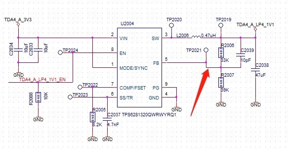

TPS62813-Q1: Whether TPS62813-Q1 support remote feedback?
Part Number: TPS62813-Q1
Hi team,
Customer used TPS659413 before, the power supply for LPDDR uses remote feedback, that is, the sampled FB is led out from the load end to the power chip.
Now it is replaced with TPS62183 to supply power to LPDDR alone. Is remote sampling required? Is there a requirement for the placement of the voltage divider resistor?
I personally understand that remote sampling requires the support of a power chip to prevent voltage drop on board traces under high current conditions. The power supply manual does not indicate this function. Does TPS62813-Q1 support remote feedback?
