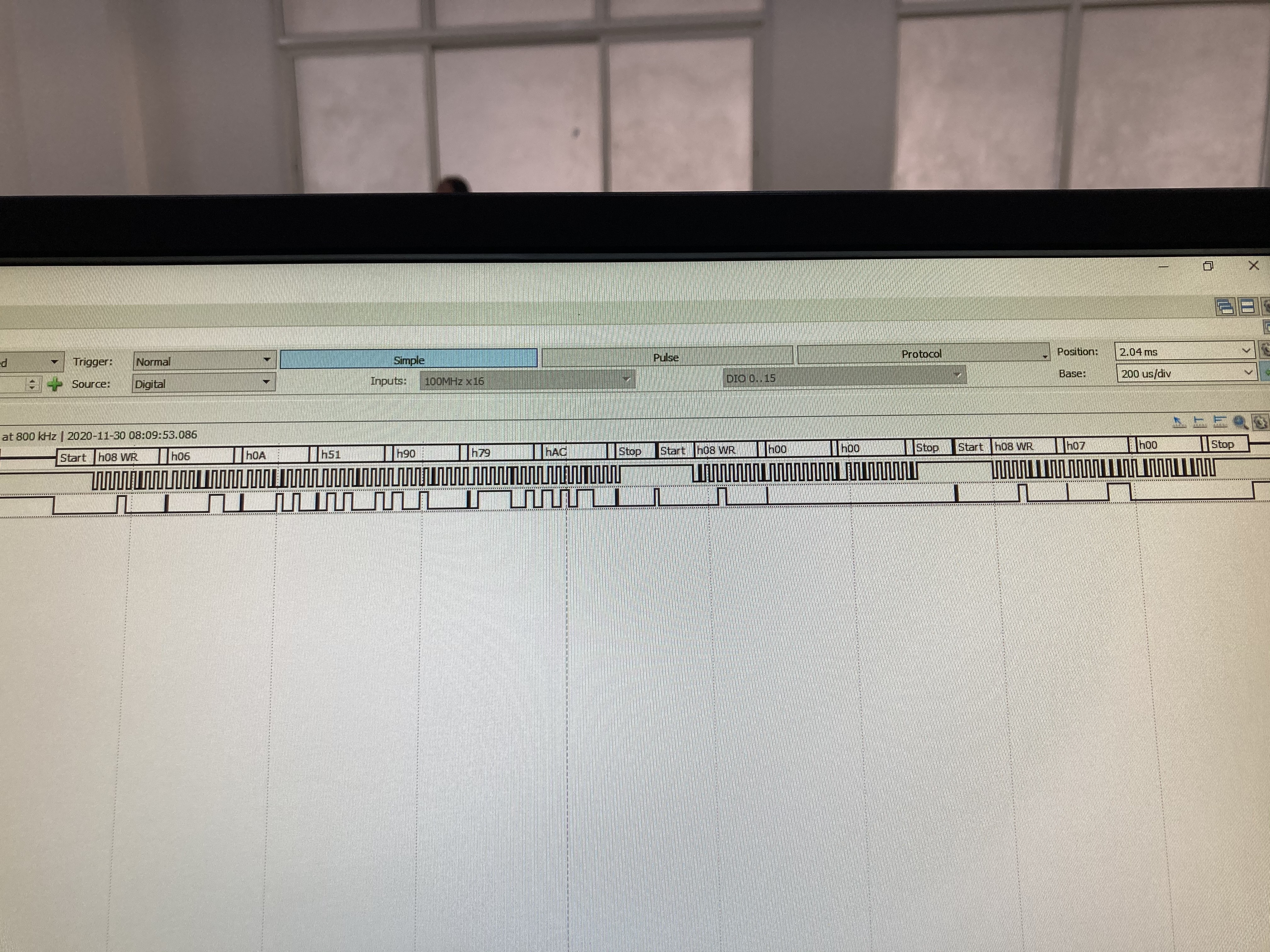

i am using BQ7694002DBTR part which is a TI AFE without CRC. I am trying to communicate with the same using my renesas controller R5F104FCG. in the write sequence and in the read sequence i am getting ACK from the AFE in the reply on the reception of the IC , Register address and after data transmission. but whenever i tried to read the data of the reqisters i am getting only 0x00 in return no other value.
So please help me why this is happening and how to solve this issue. for reference i already attached the images of the communication.
