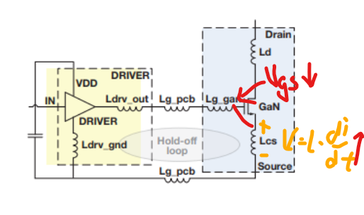

According to the TI white paper Optimizing GaN performance with an integrated driver
I have some question I would like to ask
1.) The yellow line, what is the resistor, is the GS resistor?, what is the L-R-C tank look like can someone give me a figure?
2.) in this paper, the simulation figure is using TINA-TI? or what? I want to learn this part. Does the TI provide the simulation file?
3.) In this figure, (a)(b) are have LcS common source inductance, I still don't understand what LcS affect our drive circuit

    Here are some comments on the questions:
    1. Yes it would be Rgs resistor. Think of a resistor that comes out of the driver and connects to the ground.
    2. Cadence is the tool. Sorry we don't provide the simulation files as it contains device properties we are not disclosing.
    3. The drain current will be passing through the CSI. The voltage generated by the drain current di/dt will be opposing the Vg and slow down the slew rate.

  • 1) The Rgs resistor usually use 5k~10k  why this paper use too small value
    3.) Can you give more detail example, I am still confused
    1) For GaN, it has very high dv/dt. In half bridge configuration, when high side turns on, the Cgd(low side)*dv/dt will generate relatively large current through Cgd to the gate loop. With too large resistance, the voltage drop across the resistor will be large, and it will cause Vgs of the GaN to go up, which affects the ability to hold off the gate.
    3) When GaN turns on, Lcs*di/dt will generate a voltage at the source. If the Vg is the same, as the Vs goes up, the Vgs will go down. The lower the Vgs, the slower the slew rate of the GaN.
    Please let me know if you need additional explanation.
  • 1.) if put the large would make the low side mosfet trun on, why we need to put the resistor.
    3.) Can you use a picture to explain, I think it is hard for me to understand.

    3) I did a sketch and don't know if that helps. As the V becomes larger and larger with larger L, the Vgs value will go down, which slows down the slew rate.

    3.) so the common inductance it would slow down  the slew rate, but the intergrated GaN haven't this problem right?
  • 1) If you read section 3 of the top answer, the max resistor value calculated without FET turning back on is 270 ohm with 25V/50ns slew rate (0.5V/ns).
    For our GaN device, the slew rate can go to 100V/ns to 150V/ns, and thus smaller resistor value is needed.
    3) That's correct.
