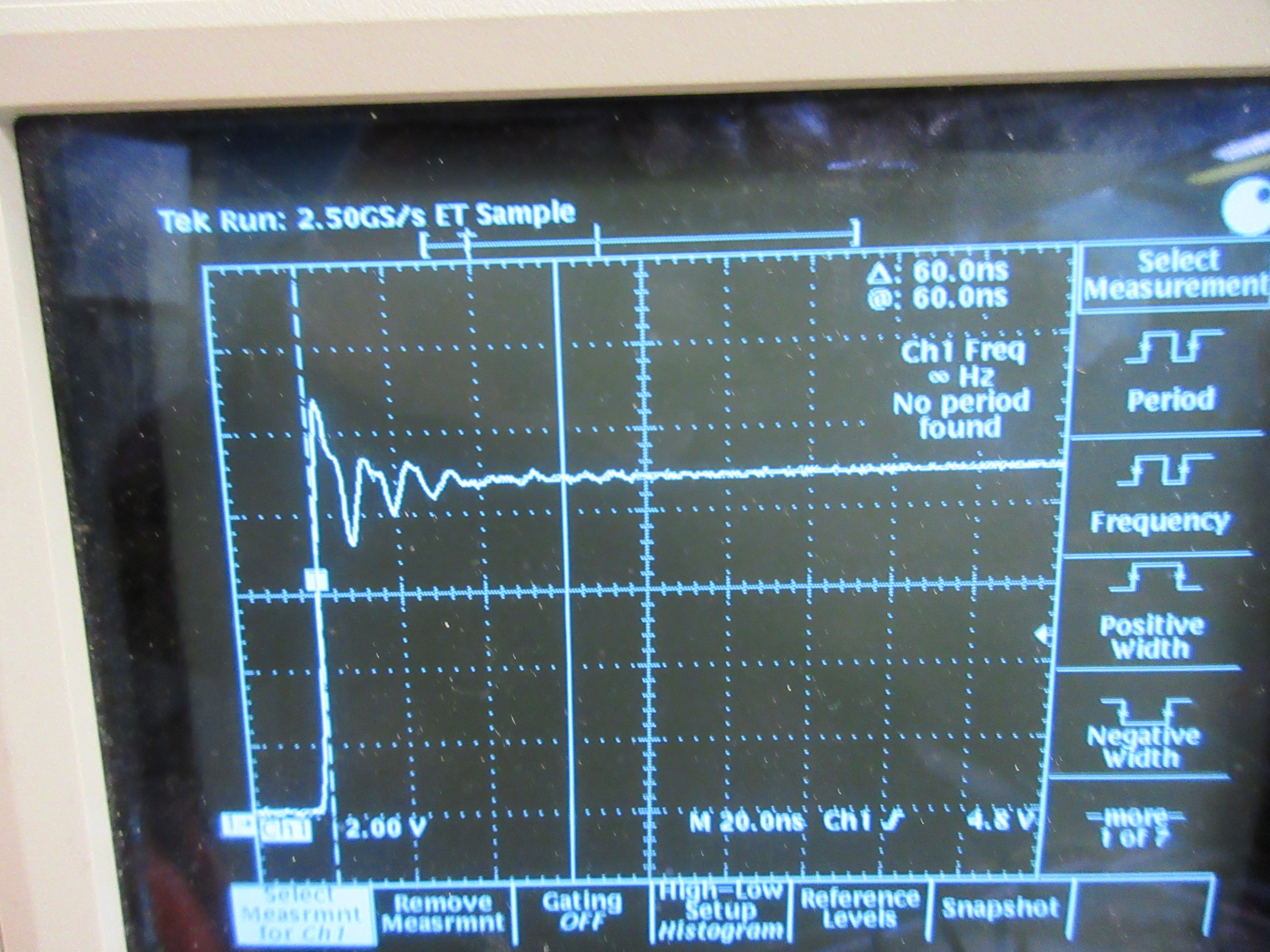

I am dealing with some ringing on the SW node of my TPS61165.  See the oscilloscope shots below:

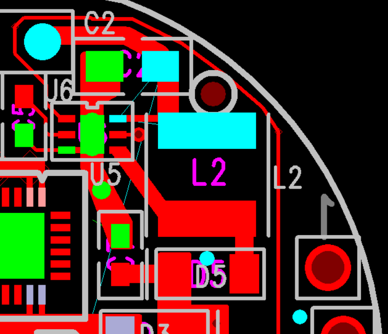

My layout is, I think, pretty good.  But please let me know if anything looks off about it:
There are two vias to ground under the thermal pad.  It is a 4-layer PCB with a solid ground plane on layer 2.
Are there any solutions that you can recommend that are specific to this device?  Or can you point me towards a general-purpose solution for this sort of ringing?

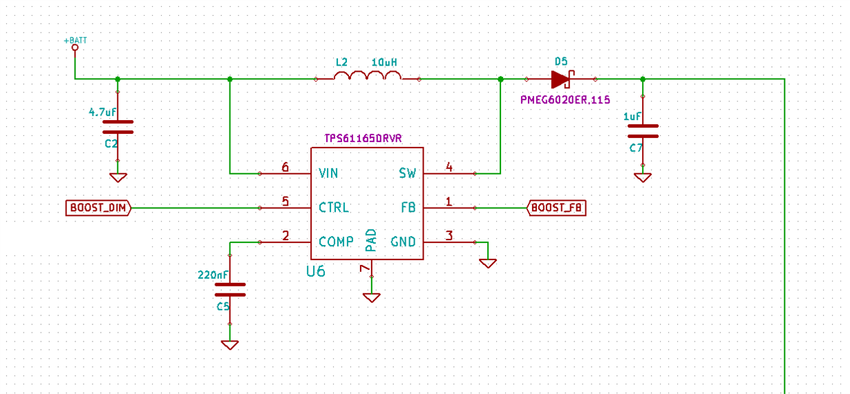

  • Here is the schematic:
    Is ringing like this not generally a concern?  I have radiated EMI issues that match the frequency of the ringing.

    FWIW, I was able to observe very similar ringing on the TPS61165 eval board.  So, I fear that this ringing is due to the driver itself.  Do you have other reports of the TPS61165 leading to problems with ringing and EMI?
  • Hi David,
    Move the inductor, Diode and Cout upward and reduce the output loop area.

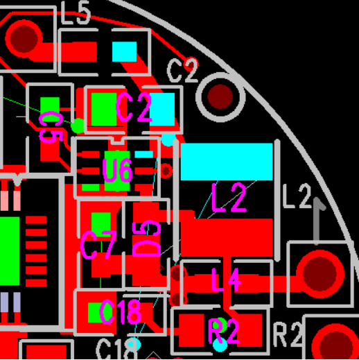

  • I have worked to improve the layout and design.  Can you give me your opinion of the changes?
    D5 and C7, making the output loop, has been tightened up and moved as close to the pins as possible.
    C18 and R2 are an RC snubber from SW to GND.
    Output capacitor C7 footprint increased from 0603 to 0805 for less DC bias effect.
    Inductor L2 footprint reduced from 5mm to 4mm.  This was mostly so I could fit the additional components, but a smaller footprint will technically give me smaller loop sizes.  Right?
    L4 and L5 give me the option of adding ferrites to the input and output.
    I have also changed the rectifier (D5) to an option with a lower capacitance - reduced from 240pF to 35pF.  Do you expect that to have a positive change?  Does this have the same effect as reducing parasitic capacitance?
  • Hi David,
    Please pay attention to the saturation current of smaller footprint for inductor.
    The attached file is related to how to select a proper RC snubber and you can refer to it.How to choose Snubber Capacitors and Resistors.pdf

  • Thank you for the RC snubber document, that is very helpful.
    Does the new layout look improved, in particular the placement of the diode and Cout?

  • Hi David,
    I think this layout is better.
    As for inductor choice, saturation current means inductor drops 20% or 30%, so you' d better choose a larger saturation current to make sure there is enough inductance when current is 1.1A.
     For metal core, its efficiency is not very good and resistance of core may a little larger.

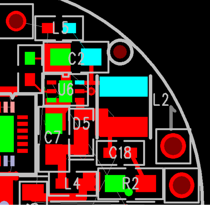

  • Hi Robin,
    Can you take a look at the current version of the layout?
    D5 and C7 are the diode and output capacitor, making a much tighter loop than before.
    R2 (0805) and C18 (0603) are the snubber.  I've made the loop from SW to GND about as small as I can, given my space constraints and the placement of the diode and Cout.  Note that I managed to connect C18 to GND on the top level.  Do you think this is better than going through a via?  Or should I add a via as well but keep the top-layer ground?
    L5 is a ferrite bead for the input
    L4 is a ferrite bead for the output.
    I have vias from the top-layer GND to the full GND plane (layer 2) under the TPS61165, and one next to Cin.  I know there is varying advice about the location of these vias regarding EMI.  Do you think they are good where they are?  Or do you recommend moving them anywhere else?
  • Hi David,
    R2 could be smaller such as 0603. If you can connect SW to GND directly, vias is not a must.PCB layout guideline for automotive LED drivers.pdf
