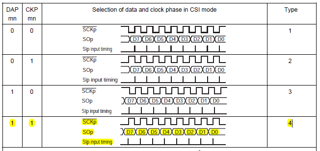

Hi TI Forum Team,
I am working on BQ76942 EVM board. Actually I want to SPI communication of BQ76942 Device with our Renesas RL78/F13(R5F10BGE) LQFP-48pin microcontroller over SPI00 Chanel.
Hardware connection Details given below how BQ76942 BMS is connected with RL78/F13(R5F10BGE) Microcontroller for SPI00 connection.
BQ76942 Pins ---------------->> RL78/F13(R5F10BGE) Pins
(1 ) SPI_SCLK(26-pin)---->>P1.7(SCK00)
(2) SPI_MISO(27-pin)----->>P1.6(SI00)
(3) SPI_MOSI(28-pin)----->>P1.5(SO00)
(4) SPI_CS(29-pin)------->> P3.0(SSI00)
My Problem points:-
(1) When I sent these following command sequence to Read the Cell 1 Voltage which is at location 0x14 and 0x15 of BQ76941 RAM location. I did not get the value of Cell 1 voltage reading,
some time we get 0x00 and 0xFF from both location.
(2) please look my command sequence or is it right command that I have sent for Cell 1 voltage reading?
(3) If the above command and its sequence is not right way please let me know both right command and its sequence for voltage reading of Cell 1
Note:- (1.)  I have Keep the SPI Communication Frequency at 2MHz from controller side , as stated in SPI supporting speed in BQ76942 data sheet.
           (2.)  I have keep the same BQ76942 SPI Interface logic operates with Clock polarity(CPOL=0) and clock Phase(CPHA=0)  as mentioned clock and data timing diagram in BQ76942 data sheet as well as in                         Microcontroller (R5F10BGE) is which is covered in type4 which highlight in Screen shot attached with it.
                                                                                              BQ76942 SPI Timing Diagram
                                    Microcontroller RL78/R5F10BGE SPI mode Timing diagram
       (3)  As per above both Timing Diagram Microcontroller Timing Diagram Type4 is equivalent to BQ76942 CPOL=0 and CPHA=0 . so we have keep mode =Type4 in our Microcontroller side.
        (4) These above setting I have maintained in our source code in SPI communication from Microcontroller side.
Our command & its sequence what we implement in our source code For Cell 1 Voltage Reading :-
