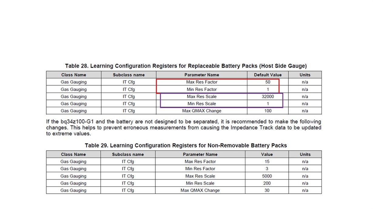

I understand from the BQ34 data sheet page 52 that Max Res Factor controls how much large of increments that IT data can be updated.  I also see the Max Res Scale value.
Questions:
1.  Is Max Res Factor a percentage ratio of the Ra stored impedance value?  If so, does 255 = 100%
2.  Is Max Res Scale is set to 32000, does this mean that the Max Res response is 32000 x the Max Res Factor value?  If so, this would mean that the Ra impedance value is allowed to change over a 100x its starting number.
Context:  My company has recently changed its setting for Max Res Scale and the IT Track performance now seems unstable and erratic.  I am trying to better understand this situation.
