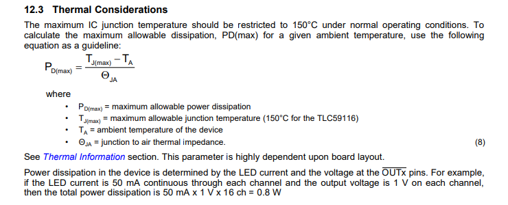

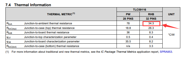

    As shown in the figure below.The formula is used to calculate the power.Tj(max)=150,How much should TA be taken as the ambient temperature for IC operation? How do I usually get it.If you use a 32 pin chip, =34.3? Please tell me the correct calculation method of the following formula. thank you.

    Take the example in section 12.3 that setting all 16 channels output current at 50mA with 1V output voltage. Whole power dissipation is 0.8W. The increasing temperature on IC from room temp is 34.3 x 0.8 =  27.4C. If you need more precise results you could also calculate power dissipation on VCC and IREF, but they should be small. RHB package have thermal pad beneath IC so the thermal performance is good.

    The IC output voltage is not necessarily 1V, but should be the input power voltage minus the LED voltage drop, which may be much higher than 1V.If the maximum current is 120mA and the voltage is the input voltage minus the diode voltage drop, I can calculate the power P from the current and voltage.My question is what is the maximum upper limit of the output power p?There must be a reference value of power that tells me not to exceed this value.Note: the maximum current per channel of the chip is 120mA.

    Sorry that I missed the notification before. I still not recommend the words 'output power p' to describe the outputs of TLC59116, because they are all current sinks that can only drive current. The voltage on output pins are determined by VLED minus Vf of LED as you said.
    The max rating of OUT pins is 20V. Every channel can support 120mA x 20V. But in this situation thermal would be generated large and beyond internal thermal shut down protection, which is around 175C. So that we recommend you design the voltage drop on output pin properly. Usually do not exceed 2V.
    If your power line of VLED is to high and the LED number you need to cascade on one channel is small, I recommend you also cascade one series resistor into the channel to separate the thermal and decrease the voltage on output pins.

    The answer I got is that the maximum current is 120mA, and the maximum port voltage should not be greater than 2V.My current design is that the maximum current is 120mA, and the port voltage is 1.3V ~ 1.5V, which will not exceed 2V.On this basis, do a good job in the chip heat dissipation is OK?
  • Hi Chaoyang,
    Based on calculation, your design may lead to 100C temperature increasing on IC. It can work normally but I am not sure if this temperature is acceptable in your whole system. I suggest you also could cascade 0ohm resistor to every channel in case there need to separate some heat. Also putting large copper area below thermal pad could help dissipate heat.
