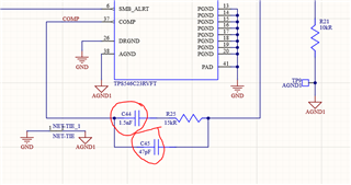

  • It looks like the WeBench design has a "custom" output capacitor selected with 5mOhms of ESR.  Based on the design and the inductor selected, with a single output capacitor with 5mOhm ESR, yes, the output ripple would be about 42mV, so from that point of view, it is generating the correct results.
     _
    What I will need to look into is why it is selecting a custom output capacitor with a 5mOhm ESR we selecting Ceramic output capacitors with no electrolytic.
  • Hi Peter,
    Yes, I saw that too. I tried changing the values, but the tool is not allowing me to do that. Can you please suggest input and output capacitors and output inductor values based on my specs? I have limited board space and want to determine if I can fit this solution on there. So size is the biggest concern at the moment.
    Noman
    For a 2V output with all ceramic capacitors, your smallest board size will likely be 1206 100uF ceramic capacitors with an ESR of about 2mOhms.  Each would give you a 500kHz impedance of about 5.1mOhms.  With the existing 400nH inductor, the design is showing ripple current up to 8.8A pk-pk, which would require 10 1206 100uF ceramic capacitors.
    For the transient spec of less than 2.5% (50mV) on an 18A load step, 1000uF ceramic capacitance with 400nH inductance looks like it will fall short, with at least 64mV of overshoot, but the XLS spec shows upto 200mV transient being allowed.
    If you want to keep the transient at less than 50mV with less than 5mV ripple, I would suggest a 400nH inductor with at least 14 6.3V X5R or better 100uF ceramic capacitors.  If you are willing to allow the transient to get higher, a slightly higher inductor could reduce the capacitance to less than 10x 100uF.
    For Cin, I don't see an issue with the 5x 22uF ceramic capacitors the WeBench design recommended.  The input ripple current is close to 15Arms, so I would not recommended fewer than 5 input capacitors to share the input ripple current.  That is leaving the input ripple just over 100mV, so I don't see much room to reduce the capacitance value of those capacitors.

    For the design of the compensation, I am including an Excel worksheet that helps design the feedback resistors and compensation value.  The tools defaults to an "R1" (DIFFO  to FB) resistor of 10kOhms, but can be scaled to other values by changing "R1"
    The tool allows you to enter 2 different capacitors types, while it calls these Electrolytic and Ceramic, they can easily be adjusted to a high ceramic and a low ceramic, if you are using 100uF and 47uF capacitors in parallel, for example.
    The default recommendations may place the zeros of the compensation a little high for an all ceramic output, resulting in very low phase just ahead of the L-C resonance, because the equations were developed when most switching BUCK regulators uses higher ESR electrolytic capacitors for a more dampened L-C resonance.  Once you have the initial design, I can help you improve the compensation by lowering one of the zeros and boosting the compensation gain ahead of the L-C resonance if that is an issue.
    Once you have it filled out with the L and Cs that you would like to use, share it back with me, and we'll review the compensation.
    TPS40KType III Loop Stability kVenable_tps546c23.xls

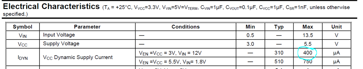

    I am not sure if I need a load switch in my application. The total input capacitance that I have on the 12V input rail is 47 uF (TPS548A29) + 140uF (TPS546C23) = 187uF. My DC connector is rated for 10A, however one of the inner layer 12V PCB trace can only handle up to 3A. So putting the max inrush current limit at 2A, the rise time should be:
    dT = (C_tot *Vin)/I_inrush = (187uF x 12V)/2A = 1.122ms
    The AC-to-DC wall adapter (datasheet attached) that I am planning on using has a startup time of 3 sec (max). Do you think I still need a load switch. If I do, can you help me select the right load switch? For a 12V input, the TI website is only showing me one option for load switch (TPS22810) and it has a max current limit of 3A, which is too low for the TPS546C23 regulator as I expect its max input current to be up to 7A. Am I approaching this issue correctly?
    Noman
  • Noman,
    Your analysis above appears to be designed to rely on the soft-start of the wall adapter to provide the required input slew-rate control.  That will work IF the user always connects the Wall Adapter to the board before plugging the wall adapter into the wall.  If the user plugs the wall adapter into the wall first, the wall adapter's soft-start is complete before the output is connected to the 187uF of input capacitance.  At that point, the only limit to the in-rush current is the series impedance, and the current limit of the wall-adapter.  Depending on how the output current limit of the Wall Adapter is implemented, it is possible that the in-rush current could significantly exceed the wall adapters output current limit and potentially risk damaging the internal 3A trace.
    I would recommend at least considering an e-FUSE (Hot-swap controller with integrated Power FET) to control the inrush current from the adapter and provide input current limiting.
    The TPS25982 (15A) or TPS24751 (12A) look like good candidates.

    The TPS546C23 discourages the user from connecting the BP3 regulator to external load for both current limit and possible noise injection concerns.  However, in this case, that is not the only problem.
    Powering the load-switch that is controller the 12V input to your board from a 3.3V LDO that is powered from the 12V input that the load-switch would be controller creates a power sequencing conflict.  The 3.3V supply BP3 will not power up until the TPS546C23 has power, but the 12V supply powering the TPS546C23 can't be enabled until the load switch receives 3.3V.
    If you can't do a Load Switch, maybe a resistor and a couple of Power FETS?
    Add a 10-Ohm resistor in series with the main 12V supply to limit the in-rush current.
    Add a P-channel FET across the 10-ohm resistor, Source to the 12V supply connector and drain to the 12V net on the board.
    Connect the Gate of the P-channel FET to the drain of an N-channel FET with a biasing resistor to the jack-side 12V supply.
    Now place a resistor divider from the 12V net on the board to pull up on the N-channel GATE when the board has 12V.  Adding a small capacitor to the gate of the N-Channel FET can help control the delay of the turn-on of the P-channel Bypass FET.
    When someone connects the 12V jack, it will initially charge the 187uF of capacitance through the 10-ohm resistor.  When the N-channel FET turns on, it will pull down on the gate of the P-Channel FET, bypassing the 10-ohm resistor and allowing the board to run normally.

    Decreasing R25 and increasing C44 and C45 will decrease the error amplifier gain between VOUT and COMP without moving the compensation pole and zero frequencies.  The whole gain curve will be lower.  If you increase C44 and C45 by 1.5x and decrease R25 by 1/3, you will decrease the loop gain by 3.5dB.  That will increase the phase and gain margin.
    R25 from 15k to 10k
    C44 from 1.5nF to 2.2nF
    C45 from 47pF to 68pF
  • Hi Peter,
    I was able to get higher than 45 deg phase margin by decreasing R25 by 1/2 and doubling C44 and C45. So the new values are:
    R25 = 7.5k
    C44 = 3.3nF
    C45 = 100pF
    Are these values reasonable to use in my design, i.e. will not impact performance at other operating conditions or area?

    The reduced gain and resulting loop bandwidth reduction will allow the output voltage to deviate more during a dynamic load change, but other than that decrease in bandwidth there should not be any other impacts.  The TPS546C23 has good, high bandwidth voltage feed-forward, so the reduces loop bandwidth should not affect the Power Supply Rejection Ratio.
