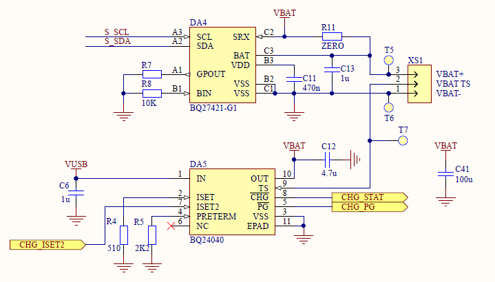

Dear TI,
We've got the following issue:
1. On charging phase both CHG and PG pins go low, as expected.
2. On fully charged battery and IN = 5V we have CHG = hi-Z (as expected) and PG = hi-Z.
For p.2, what's going wrong? Should we expect PG still have active (low) level when charging cable is connected and battery is fully charged?
  • Hi Dmitry,
    Do you have a schematic I can look at to ensure everything is set up correctly? Can you show a waveform with measurements for the IN, BAT, and /PG where you observed p.2?
  • Hi Anthony,
    it's here. R11 is NC. CHG and PG pins are directly connected to the MCU inputs with internal pull-ups.
    Unfortunately, it's hard to get a waveform right now. Do you have any ideas to investigate the issue further?
  • Hi Dmitry,
    We'll see what we can do with the information. Are you able to replicate this behavior if you don't use internall pull ups (if this is possible)? I also noticed that your  ISET resistor is 510-Ohms. We recommend putting it between 540-Ohm and 10.8-kOhm. Is it possible to increase this resistor value?

  • Hi Anthony,
    Thanks, we'll check different resistor values later. Should note that we have the same behaviour independently on ISET2 level for 100, 500 and resistor-based settings; still, the setting works fine - it changes chaging current as it should be.

    Voltages are:
    IN = 5.005V
    VBAT+ = 4.115V (could differ a bit from gauge report due to uncertainities and changing of current drawn by system)
    TS = 0.522V
    difference between OUT and system power (gauge input to output voltage): around 0.5 - 0.7 mV with steady state current drawn by whole schematic
  • Hey Dmitry,
    Thanks for the information. It looks like charging is working properly. Is this issue seen on multiple units and is the observation reoccurring consistently? It sounds like you've already got this on a PCB is this correct?
  • Hi Anthony,
    I'm sorry for that, we've found that there is a firmware bug on current samples.
    There was an issue with first batch of device samples, but it was related to poor soldering of PG and STAT pins. For now, all works fine.
    Anyway, thank you for help.
