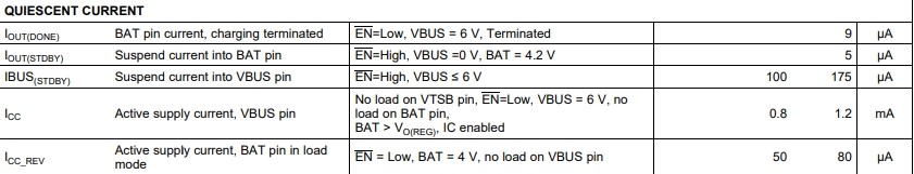

    When not charging, what is the battery leakage current caused by the charging chip? Which of the following parameters reflect this parameter?
  • Hi Amelie,
    IOUT(STDBY)=5uA.  If that is problem, then recommend that they add a PFET from BAT pin to Battery that disconnects the battery when no input source is available.  /PG can drive the gate of the PFET.

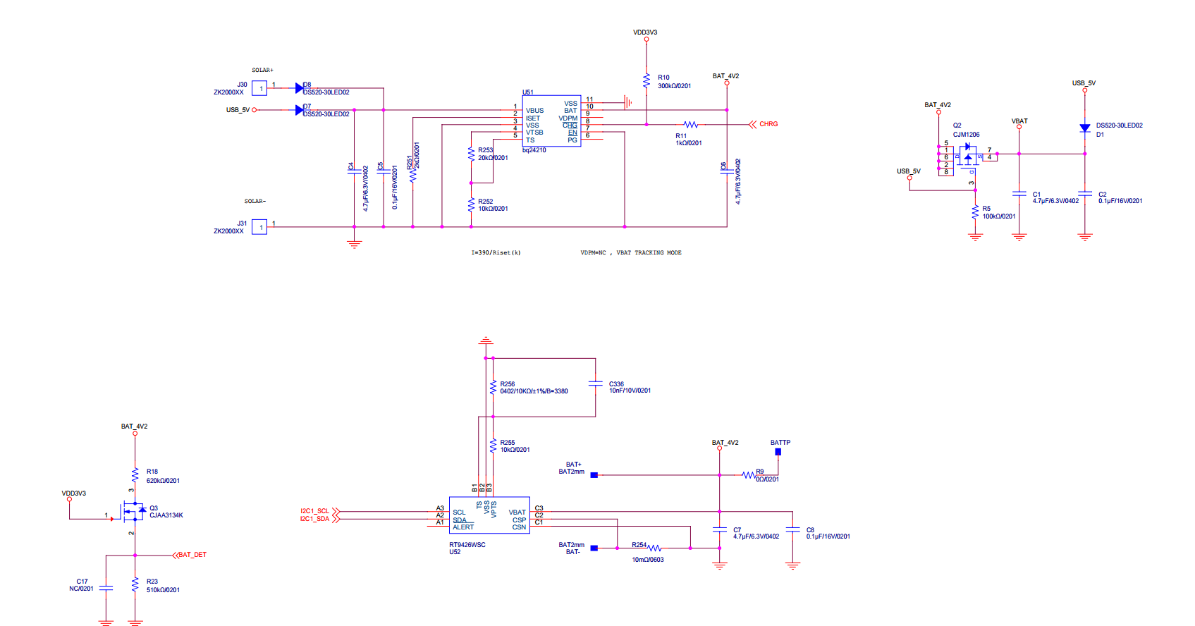

    The charge voltage of BQ24210 is 4.2V and do we have p2p to support 4.35V? Customer's battery is 4.35V.
    And the attached file is SCH of customer. Could you also double confirm whether it is ok?
  • Hi Amelie,
    There is no 4.35V version of this device.
    Regarding the schematic, all looks okay except for the pullup resistor from VTSB to TS.
    I am going to forward this post to the key support person for this device.
    Jeff
  • Hi Amelie,
    I took a quick look at the schematic and it looks like the resistor R253 should be the closest resistor value to 43.764k based on the following equation:
    With V_V45C being 18.6% of VTSB and using a 10k resistor at the TS pin, this becomes (1/(.186))*10k - 10k = 43.763k
    As for the 4.35V p2p, we do not have one that's p2p but we do have some devices in our portfolio such as the BQ24045 that can do 4.35. I do not believe there'd be many changes from what is already there.
