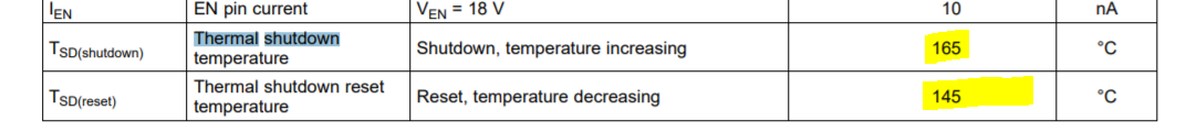

(1) What is the operating variation temperature of the TSD operation start / release temperature?
    Is the operation of TSD a design guarantee?
    --Thermal shutdown is normally obtained from bench testing as the design model is not that good at extreme temperatures. We don't expect to see a big shift in the temperatures from unit to unit. But it's a typical number.

    For (1), the customer understood "TPY of TSD"
    Please indicate the upper and lower limits of the TSD design start and release.

  • Hi Yamada-san,
    --We only have the typical thermal shutdown number, as this is not a parameter that runs at production. The customer is not intended to use the LDO near thermal shutdown temperature. In the lab, to run one thermal shutdown test, it normally takes 30 - 60 minutes, and in order to have maximum and minimum temperatures for a parameter, we need to run thousands of data and this is simply not possible and not feasible. We cannot use simulations to get the min and max values either because, at extremely high temperatures, the model is not accurate.

  • Hi Janson-san,
    For (1), the answer seems to be a little different from the customer's intention, and the customer has an additional question.
    ## Customer question ##
    What I would like you to answer is that there is a variation in the TSD start temperature, which is predicted by the TSD design simulation, so I would like to confirm that temperature.
    *Temperature at which TSD operates at the latest: MAX temperature
    *Temperature at which TSD operates fastest: MIN temperature
    Migaki YAMADA (SATORI-SPT)
  • Since the maximum recommended junction temperature is 150C, and the device has been tested for functionalities up to 150C. The TSD temperature will be higher than 150C.
