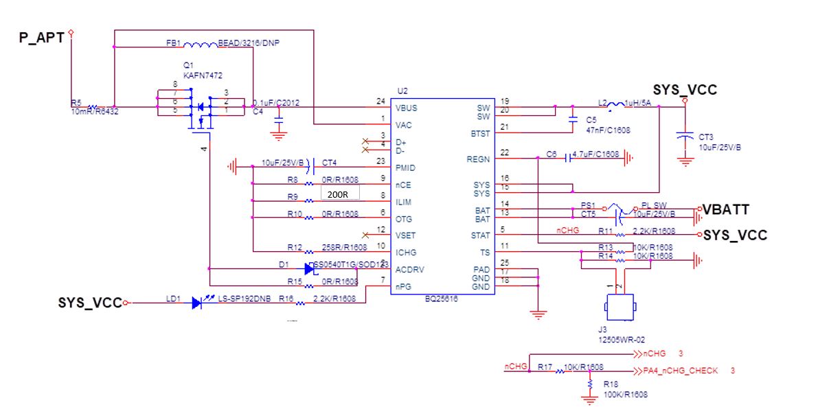

Hi TI expert,
The battery charging current max is only 500mA. charging current set is 2.62A(677/258).
Input current set is 2.39A(478/200).
Vin = 12V
Please check if there are any mistakes in the circuit.
