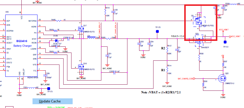

I have the following queries with the charging IC BQ24616 .Although i have read the datasheet ,I have the below queries to be clarified to proceed with the design.
Attached the design schematics FYR.
Note:The VBAT voltage is designed for 12.6V and not 8.4V

  • Hi Kedar,
    Can you please check the attached circuit connection highlighted and confirm if it works fine . I have connected the BATFET drain after the switch(Q23 below batfet) that controls the charging line that is used to turn on or cut off the charging line to the battery(to isolate the battery when required) Kindly let us know your suggestions on this!
  • Hi Vishal,
       This is correct connection of the BATFET. The intrinsic body diode is oriented in the correct direction. You can refer to the EVM schematic available in ti.com as well
