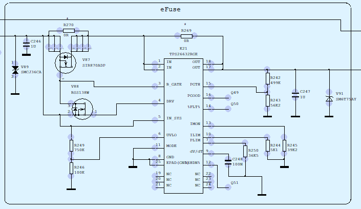

I am attaching my TPS26632 Efuse circuit schematic. Right now my circuit doesn't work at 10V. If I bypass the efuse , the circuit works normally.So something is limiting the efuse to not work at voltages less than 11V.
My device conditions are :
Under voltage : 9.5V Min
Operating voltage: 10V
Max voltage :35V
Max Inrush current : 3A
Current limit : 5 A
Power limit : 62 W
Cout =129.2 uF
I have replaced a few resistors with new values to make it work at lower voltages. So right now these are the values that I am using , but still it doesn't work at 10V during a cold start. Could you please let me know the changes to be made to make it work at 10V?
PLIM : 62K ohm (62 W)
ILIM: 3k ohm (6A)
UVLO : R1- 750k ohm, R2- 150k ohm (7.2V)
CdVdT: 10nF
Thank you
Sreeroop

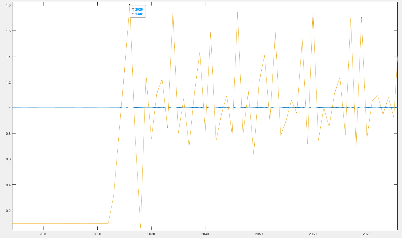

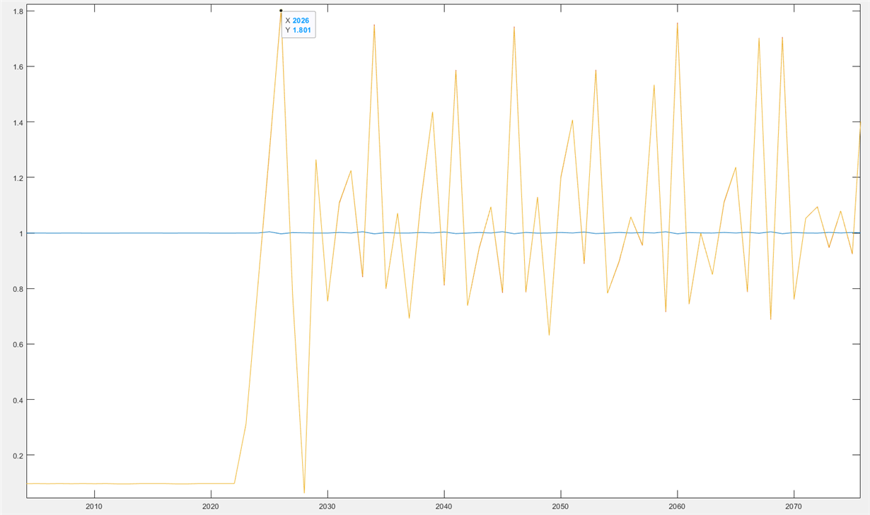

Behavior of Efuse at 10V input and 7.5 ohm load is as follows:
  • Hi Sreeroop,
    Welcome to E2E!
    Somehow your images are not showing up. Can you repost them ? Can you share startup test waveform with UVLO, input current, Vin and Vout
    Best Regards, Rakesh
  • Inrush current of 1.8A at startup at 10Vin
  • Hi Rakesh,
    Thank you for responding.
    I am really sorry, I don't have the equipments right now to share the startup test waveform.
    Could you please help me to find the required resistor values to make it work according to device conditions as specified above?
    I have opened up all the tabs, increased the current limit to maximum, i.e 6 amps, No power limiting, Undervoltage lockout set to 7V and changed the dv/dt capacitor to 10nF which is its minimum recommened value and still it doesn't work at 10V input.
    I also have noticed that when I change the dV/dT capacitor to 1nF to allow more inrush current, circuit is working fine. But since it is below it's recommended minimum value can I do that? Could you please advise?
    Thank you
  • Hi Sreeroop,
    Looks like the start load with slow ramp is causing the device to thermal shutdown.
    Is it starting with only Cout and without R-load ?  or with only R-load and without Cout ?
    What is the actual load ? Is it working fine at 10V when interfaced with actual load ?
    Startup test waveform with UVLO, input current, Vin and Vout would help to debug.
