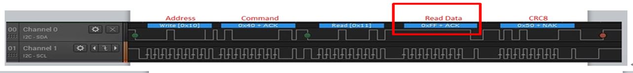

Following the OTP programming Guide, we want to use command for OTP progrmming.
But the read data of subcommand 0x00A0 (OTP_WR_CHECK) is always 0xFF in CONFIG_UPDATE mode.
Please refer the figure as below,

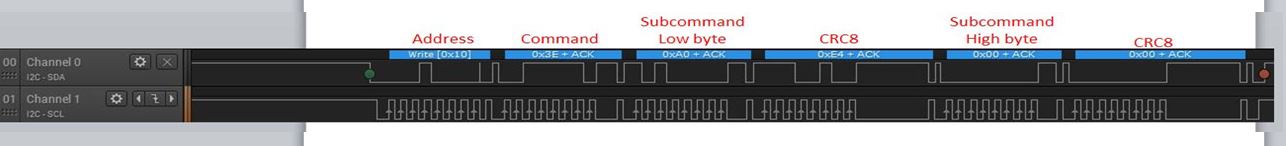

Step 1 Write command to enter CONFIG_UPDATE mode
Step 2 Read subcommand OTP_WR_CHECK
Step 3 Read OTP_WR_CHECK data, the return value is 0xFF
If we exit CONFIG_UPDATE mode and the OTP_WR_CHECK  data will be ok.
Please provide the suggestions for us and let us know which points we need to pay attention.
