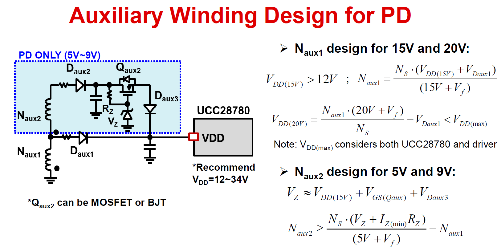

Hello:
Can you restate the expected output for the transformer with ratios
pri: sec = 5.5: 1
Pri-AUX: 3.14:1
pri:aux2= 4.4:1
These numbers appear to be for 20V output. One can verify these from SLUC644c spreadsheet.
What is the purpose of AUX2?
Furthermore, in TIDA-01622 schematic, transformer is shown to be 22:4:5:13
22:5 would represent AUX2 coil not AUX1 as implied by the WE datasheet referenced in the BOM.
And 22:13 seems awfully high turns ratio : yet the schematic shows AUX2 is rectified, followed by emiter follower to drive UCC28780 . What is the rationale for this option?
If you want to get 5 v output, does it not mean that the converter has to operate in sub-optimal mode with 22:4 ratio? Unless dropped by LDO to 5V from 20V ?
Is it possible there is a typo: turns ratio should be 22:3.14 for AUX1 instead of 22:13?
It is quite confusing.
Any comment to review these ratios will be highly appreciated.

  • Hi Robin,
    This reference design is a standard PD output , from 5V to 20V adjustable.
    For 20V output ,  AUX2 winding is used for VDD supply . so VDD voltage is around 20V * AUX2/SEC =20* 5/4 =25V
    For 5V output, AUX2+AUX1 windings are used for VDD supply so rectified voltage is around 5* (5+13)/4 =22.5V , Please note that there is a LDO after AUX1 rectified path.  and the reference voltage of LDO is 15V . that means the LDO will be disabled when output voltage at 20V and 15V
    Two AUX windings circuit is very common used in PD design , it's a higher efficiency solution compared with only use one LDO.
    Hope this can answer your questions.
    Thanks.
  • Jaden
