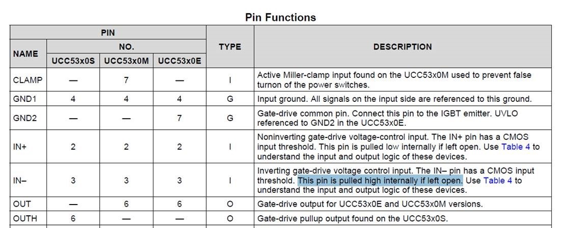

Dear Team,
Here is Kevin from Delta Taiwan team.
May I know the pull high resistor here?
Is UCC5350, UCC5390 have a different pull high resistor?
If yes, please provide different pull high resistance values base on the different part numbers.
BR
Keivn
