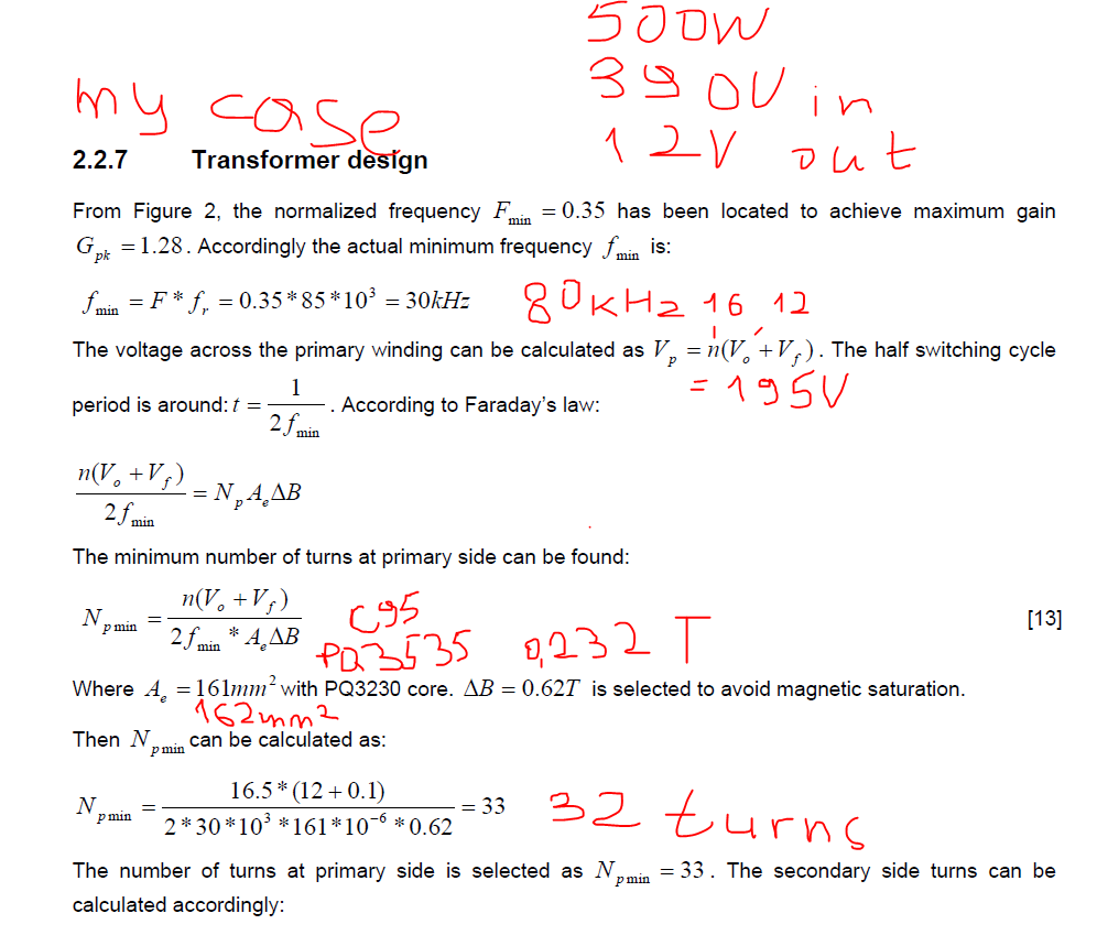

I am in designing transformer in LLC configuration. The procedure i follow is attached below.
1. How come to choose deltaB = 0.62 T, there will be enormous losses in the core ? I have chose 0,232T considering the losses in the core and also the window factor ( windings turns ).
2. Is it appropriate to play with the value of Cr ( LLC ) to adjust the desired inductance Lm of the transformer ?(  After i have calculated the turns i adjust the Cr value to get a magnetizing inductance value with which i will have reasonable air gap. )
