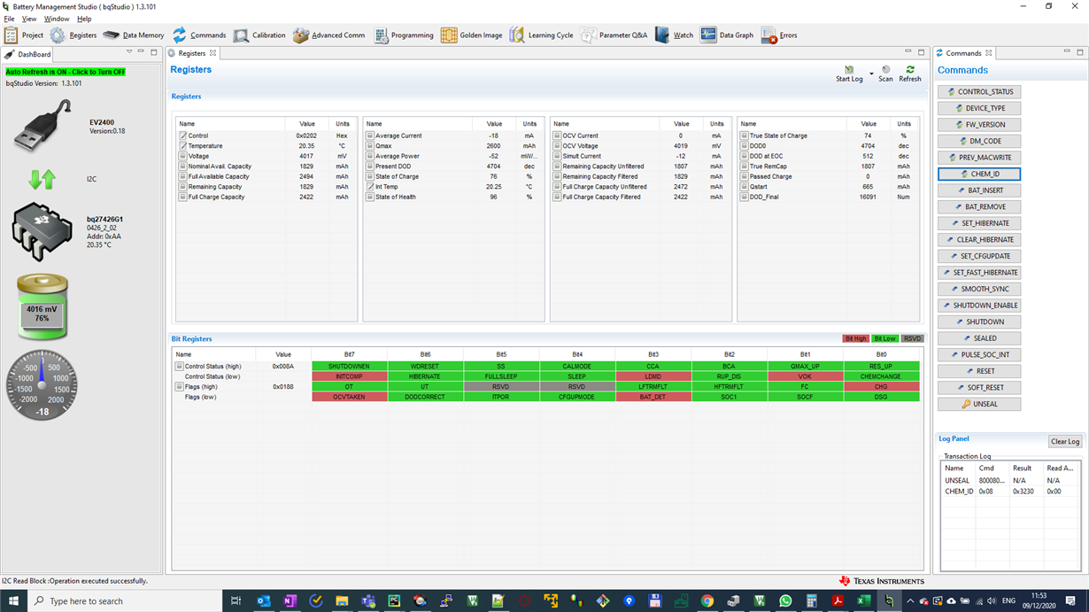

I connect to my fule gauge (bq27426) using a EV2400 board and bqstudio version 1.3.101.
The chemistry tab does not appear in bqstudio.
Please advise.

Hi Wyatt ,
I know, that, but how do I choose the correct option out of the 3 pre-programmed options?
Yaron
Hello Yaron,
You have to send a command to the gauge, you can follow the TRM:
5.1.15CHEM_A:/B/C 0x0030/0x0031/0x0032
This subcommand instructs the fuel gauge to dynamically change the active chemistry after reset. A SOFT_RESET should be performed after running the CHEM_A/B/C commands. This subcommand is only available when the fuel gauge is UNSEALED. After this command is executed, a control status word CHEMCHANGE will be set to indicate that the chemistry has been changed.
There's also an example of the exact commands needed to do it manually with an MCU.
