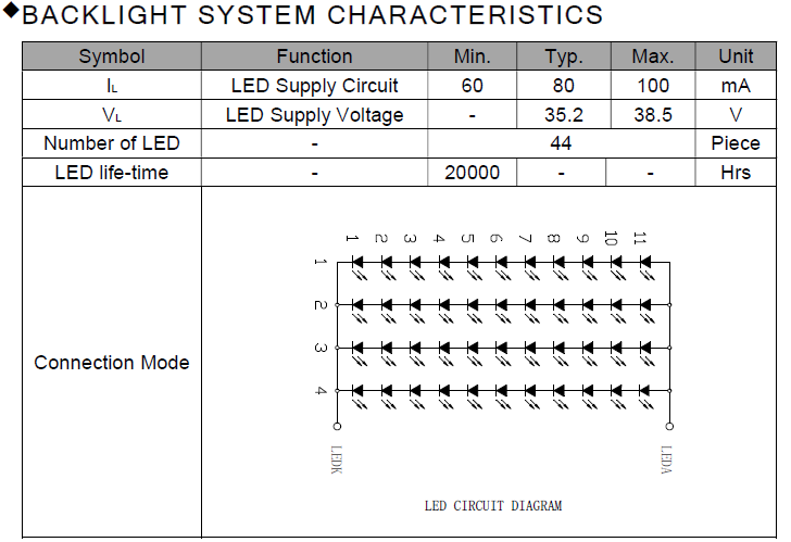

TPS61165: Is TPS61165 IC suitable as a backlight LED driver for driving 100mA, 38.5V with 44LEDs (11LED's in series with 4 strings)
Part Number: TPS61165
In our design we want to use TPS61165 as a backlight LED driver IC for 10.1" display and below image gives you the requirements of the 10.1"display unit. Is this part suitable for my application, please check and confirm.
LED configuration is 11LED's in series with 4 strings as mentioned in below image.
