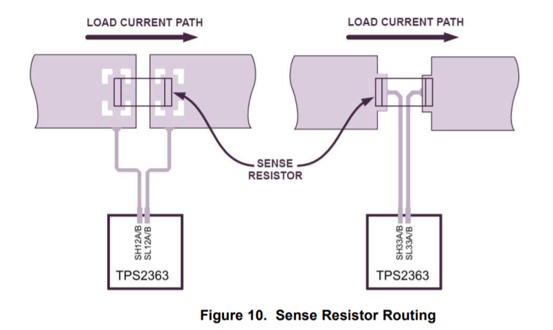

  • Hi Praveen,
    The current limit setting of TPS2363 is dependent on the voltage across SH12A and SH12B which is the voltage across RSENSE.
    In your schematics, it is not very clear on the connections between RSENSE and SH12A/B (12VSENSEA/B). That is, the netlist 'P12V_GPU0_SENSE_P' is not shown as connecting to the RSENSE, R134. Is it a error in schematic ? Can you please share the entire schematics ?
    If the connection between RSENSE and SH12A/B (12VSENSEA/B) are correct as shown below, the current limit of 12V rail should be at 12.5 A because the RSENSE = 4 mohms.
    As you are not observing correct current limit behavior, please help with the following,
    • Layout file for review
    • Waveform capture during current limit test
      • Vin, Vout, Gate, Iin
      • Vin, Iin, C_FILTER, Gate
    • Change the IC with a new IC and perform current limit tests. This is to check if the IC on your board is damaged.
