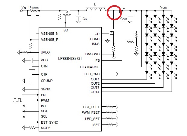

My customer got a CPCAP_STATUS error while lowering the VIN voltage.
The VDD voltage has not fluctuated since 3.3V.
When they monitor the voltage of the CPU MP pin, it drops momentarily.(about 2V)
