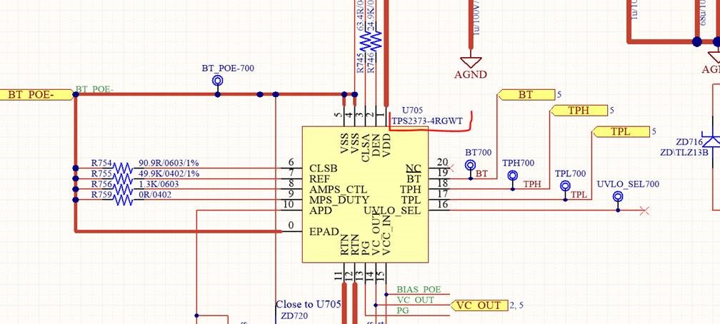

Dear Sirs,
I have some questions about the PD class and looking for the answer.
Thanks.

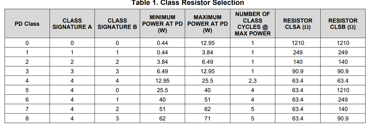

1. My design that using TPS2373-4 now and set PD class as class8, Is it ok to change to class6?
2. After changed to class6, how many watts (max) I will get from PSE?
3. If the PD class is adjustable for TPS2373-4, what is the difference with TPS2373-3?
4. Did TPS2373-4 support auto class function or not?
