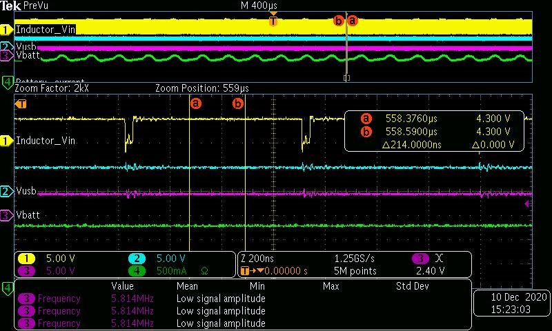

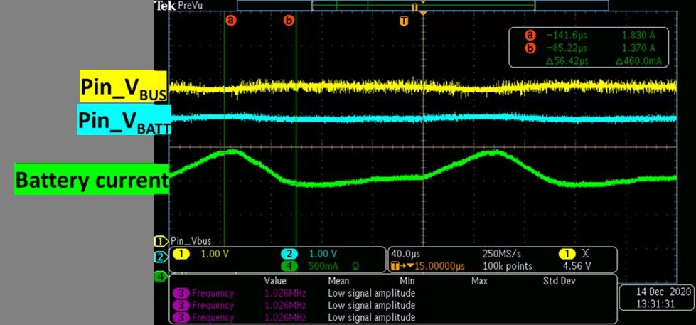

We are using BQ25606 now and we are finding if the VBUS is 4.5V-4.6V, the charge current through the battery will have oscillation. If we boost the VBUS to 4.7V, the issue will disappear. (VBAT = 4V,Icharge = 1.8A)
(Measurement is showing as below. Green line is Icharge. Top is long scale and bottom is enlarge.)

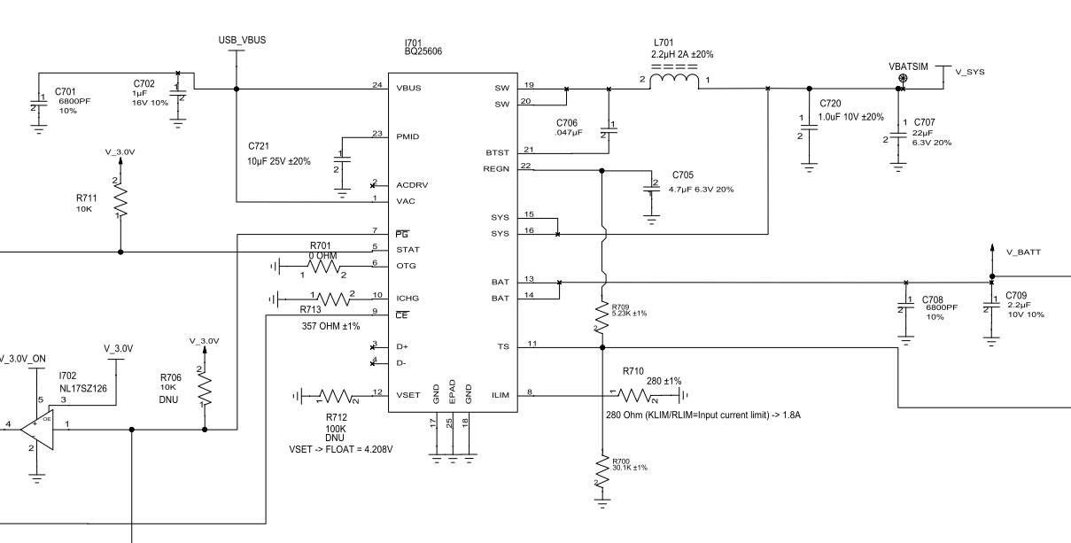

Schematic is showing as below.
Do you have idea for this issue?
