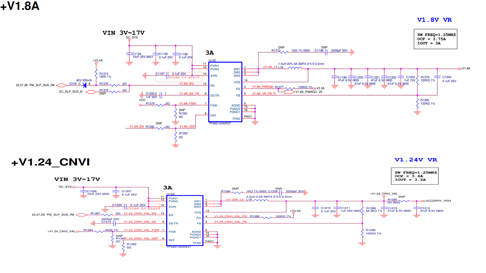

Could you help check the TPS62130A schematic as below and any need to adjust?
Hi Gareth,
The schematic you attached looks to meet our design requirements for the TPS62130A. In regard to U132, it is generally best practice for the smaller Couts to be placed closest to the IC.
