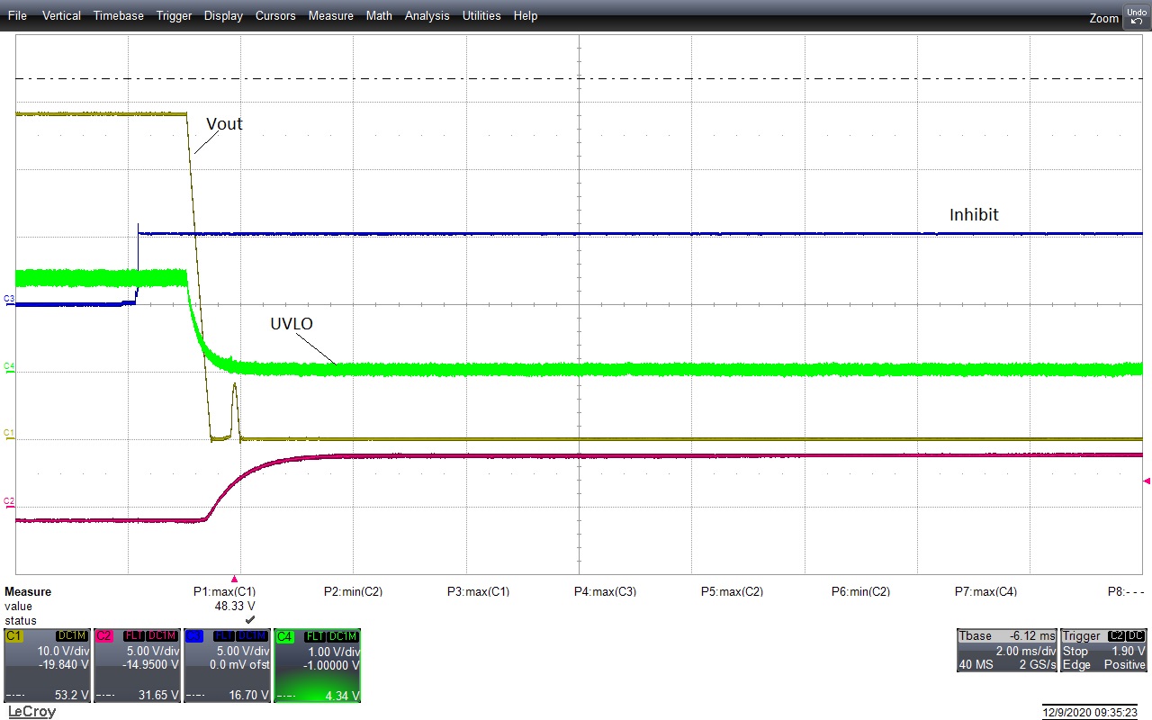

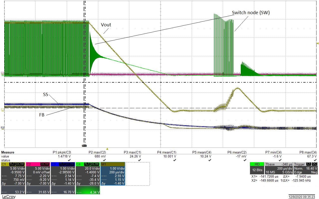

I am using the UVLO pin on the LM5116 to enable/inhibit a buck converter. If I inhibit the converter at full load I see a pulse on the output, typically up to a quarter of the nominal output voltage, a few ms after the output initially fell to zero. If I reduce the load the output inhibits cleanly.
As far as I can see, I still get activity on HO despite ULVO being below 1V at the time of shutdown
What are TI's suggestions for a fix or workaround?  My inhibit signal is opto-isolated so is too slow to drive EN directly.
