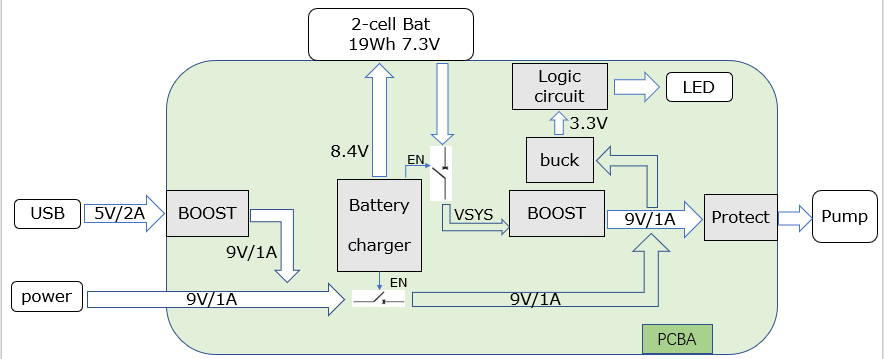

I am working on a new design for which I am sure TI has a nice specific part, however, I have not been able to find the suitable one so far. This are the summarized requirements:
  • New design is more like a power bank for an infusion pump with embedded battery, and none software .
  • The input power comes from a 5V/2A USB port or 9V/1.1A adapter power supply
  • The system bus of the design is 9V±5% ,1A.
  • We will be using a 2 -cells smart battery with PCM , provide overcharge or overdischarge protection
  • A power-path management is required , so that the system is operational for supply by external power and battery
  • The most important require is ensure system current enough for the system . So need DPM or DPPM
  • When external power or load detected , a led need be present for power status (full/near empty/empty)
Here is my preliminary solution
  • BQ24133 is battery manager,because It had use other production
  • TPS61175PWP, 5V TO 9V ,the boost between the BQ FET and USB port
  • TPS61175PWP, 8.4V to 9V, the boost between the battery FET and the system rail
  • INA1180 , current detect with small sense resist,the sense res is between system rail and output connector.if system current above shield value then disable the charge.
  • LED driver use some comparator control and judge by battery voltage.
 Design diagram as below:
However, I am confident that TI may have specific parts suitable for this "common" application. If so, can you suggest any specific parts? If not for the whole power-path design, maybe for a subset of it?

  • Hi Kyrin,
    Unfortunately, TI does not have a stand alone (meaning not requiring host processor and software) buck-boost charger that can accept both 9V and 5V input to charge the battery.  Your selection of BQ24133 seems to be the best fit.
    If the you want to eliminate the front end TPS61175, you might consider the BQ25792 buck-boost charger running in default mode (with ICHG=2A).  It can accept both 5V and 9V input.  However, it is NVDC power path not direct power path like BQ24133.  Therefore, the SYS output to the secondTPS61175 will be the higher of the charger's default MINSYS voltage (7V) or the battery voltage.
    Jeff

  • Hi Kyrin,
    Options for standalone buck only (meaning you have to use input side TPS61175) include BQ24105 or BQ25616 with NVDC power path.  I do not think your concern about the noise on ISET pin is valid.  If you use a FET to pull that pin to ground, any noise on ISET=ground would move the entire chip ground.
    Yes, boost on output is needed with NVDC power path charger.  The battery supplements system load if the charger cannot provide the required system load current.
    BQ25886 is not an option because its max input is 6.5V.
    Efficiency curves for BQ25792 are on datasheet page 21 figure 7-4 for VBAT=8V.  The max output current for each input voltage is the last data point for each curve. Efficiency is higher when input voltage is closer to output voltage.
    Jeff

  • Hi Kyrin,
    BQ24617 is an option but it requires external FETs.  Your current isn't high enough to warrant the heat distribution that external FETs provide, in my opinion.
    You can estimate the input power needs by using a power balance: eff=Pout/Pin=VBATREG*ICHG/(VIN*IIN).  For example, if the charger is 93% efficiency and you have 5V input source and ICHG=2A, 0.93=8.4V*2A/(5V*IIN) -> IIN=3.61A.  So, with a 5V, 2A input source, you cannot charge at 2A.
