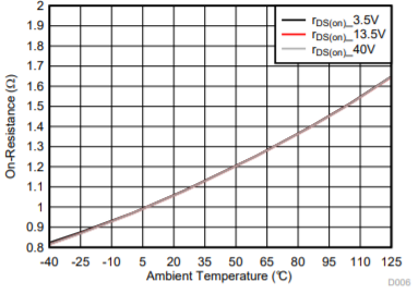

  • Hi Jorgen,
    Thank you very much for the extra details. The following image can be found on page 8 of the datasheet. If you are using the lowest possible temperature then the device Ron resistance will decrease by a max of 0.2Ohms.
    I believe that in addition to this factor, you should consider the heat emitted by the device itself when dissipating power. I am uncertain about this assumption, but I will go ahead and do a deeper investigation here. I will have you a certain answer by end of today. However, looking at the loading values you have provided me, this would not make a significant difference.

  • Hi Jorgen,
    As a follow-up, for the Ron resistance in this case, if looking for the worst-case scenario, you will be using your ambient temperature only. Thank you very much for reaching out here.
