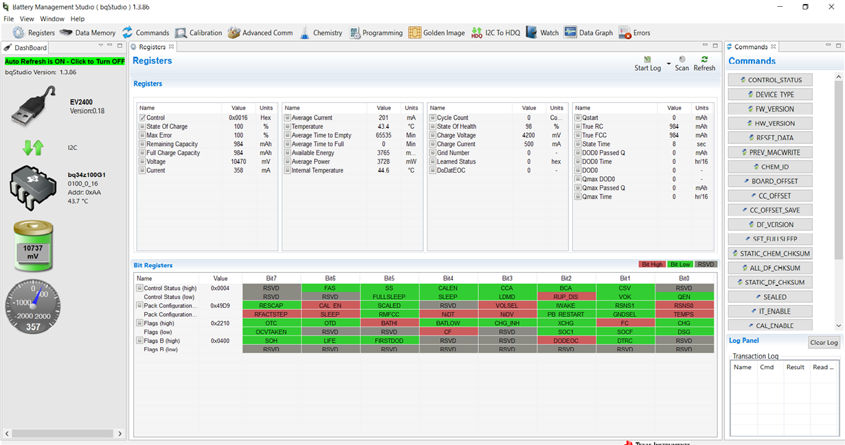

When we look at charging or discharging behaviour of the system, we find that Charge/discharge current were not the same as actual current being charged or discharged from battery.
We were having about 280mA discharge current but EV2400 shows about 306mA current.
How do we get CCGain and CCOffset values to ensure that the number seen with EV2400 is same as the one actually going through charging / discharging of battery?
Second part is that we are not getting right value in "Average time to empty" and "Average time to full".
In charging case, "average time to full" shows 0 value while "Average time to empty" shows up 65535.
In discharging case, "Average time to Empty" shows up value but am not sure if it is correct, and "average time to full" will be 65535.
How to get these parameters correctly?

  • Hello Dharin,
    Have you found a chemistry ID using the GPCCHEM tool and completed a learning cycle? You should perform calibration as described in the EVM users guide and then use GPCCHEM and do a learning cycle for the gauge to report accurate values.
    The learning cycle steps are in the TRM.

  • Hello Dharin,
    The calibration steps are in the EVM users guide: www.ti.com/.../sluu904a.pdf
    It is section 3.3 Calibration Screen.
