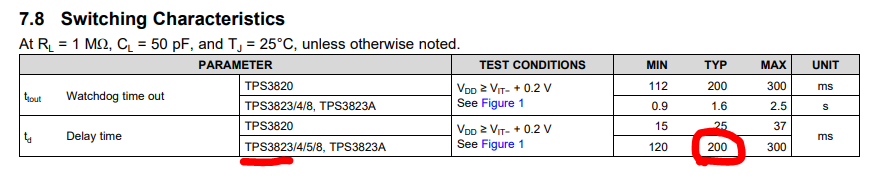

Hi, we are using TPS3823-33 voltage monitor with watchdog timer in our design.
We are little bit confused about MR pin behaviour.
As is mentioned in datasheet: "Manual-reset input. Pull low to force a reset. RESET remains low as long as MR is low and for the time-out period after MR goes high. Leave unconnected or connect to VDD when unused."
How long is "time-out period after"? It is the same than Watchdog time out (ttout )?
