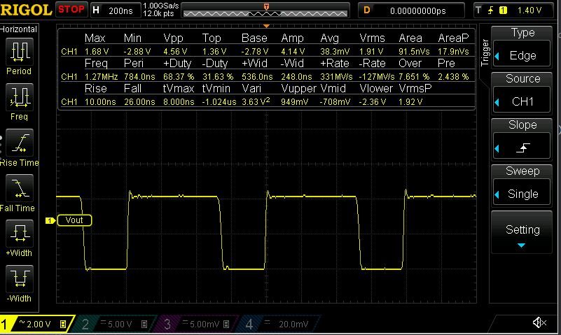

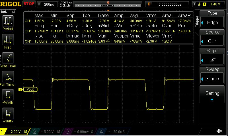

  • Here is the waveform for the SW.

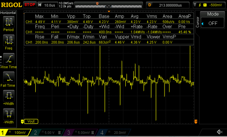

    And for the Vout
  • Hi Carlo,
    I don't think it's a good idea to simulate LED characteristics by diode since diode voltage drop is not similar with LED.
    For Vout waveform, is there plot by DC coupling?

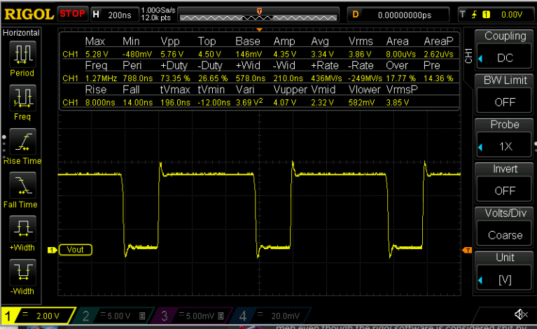

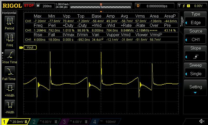

  • Hi Robin,
    Good day.
    According to our customer, they do not have high power LEDs that match their design's output current and voltage requirements. Here is the waveform provided and it kept falling out of oscillation. According to them, it behaves the same under a laser diode load which acts identically to an LED but is even more sensitive to thermal runaway.

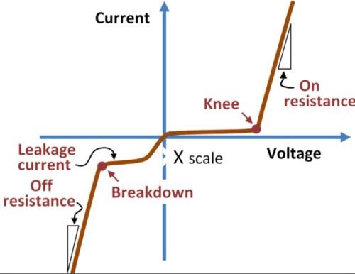

  • Hi Carlo,
    Please refer to the below diode I/V curve. For larger current (e.g. 1.3A), it will need much larger voltage than normal LED, which may beyond the TPS61500 output range. However, for 800mA, TPS61500 may have the capability to boost.
    So, please convince the customer try again with LED.
