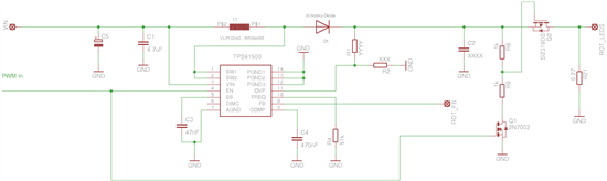

So we designed our circuit based on the "Typical Application" Figure 2. Pure PWM Dimming Method. Here is the schematic of our application:
Description of the Schematic:
* The LEDs are mounted on a seperate print and are connected serially.
* The PWM Signal is assigned to the PIN 4 (EN) of the TPS and to the FET Q1.

Our main problem:
In our setup we have a Vin of about 12V and a Vout of 36V. While we tested the circuit we noticed that the output voltage is not high enough to power 10 LEDs. The output voltage was as high as the input voltage. For that reason the LEDs aren't iluminating any light. Therefore we assume that we have a mistake in the part of the circuit where the TPS61500 scales the voltage up to Vout.

  • From Vin=12V, the TPS61500 should work for you.  What values did you select for R1 and R2?  These values must be installed to set the over-voltage protection level.  For your application, that would be the max 38V.
    For Vin=5V, the TPS61500 will not work.  The TPS61500's 3-A current limit will prevent it from providing the power that you need.  You might consider the TPS40211.
