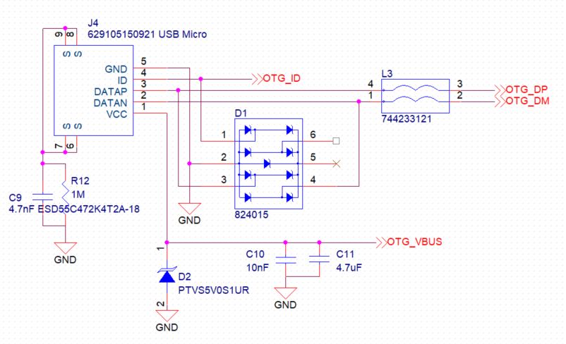

VBUS is provided through a USB connector:
Only OTG_VBUS line is connected only to the battery charger, other USB lines are connected to a microcontroller for data communication.

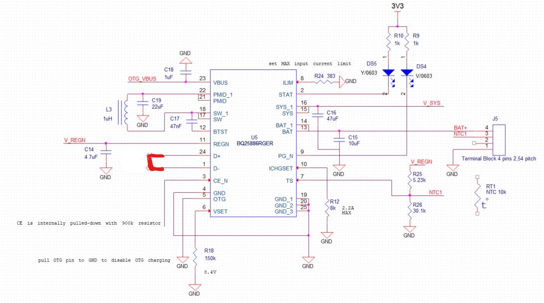

Here's the schematics of the current version of the prototype (which has the abovementioned issues):
  • the boost LC inductor part number is the same for both versions: DFE252012F-1R0 (Murata).
  • CE_N pin is connected to a uC pin which is left float (charge is enabled as CE_N pin is internally pulled-down), same as the previous version.
  • OTG pin is connected to a uC pin which is left float (OTG charging is disabled as OTG pin is pulled-down thorugh 10k resistor R21); in the previous version OTG pin was directly shorted to GND.
  • ILIM pin is shorted to GND to set maximum input current limit; in the previous version it was connected to GND through a 383Ohm resistor (I took the schematic of the BQ25886 datasheet as a reference); nonetheless, i think it does not make any difference since inside BQ25886 datasheet it is stated the ILIM pin can be shorted to GND.
  • both STAT and PG_N output pins are left float as they are not used to drive LEDs nor to signal anything.

The differences wrt the previous version are that now OTG_VBUS is disconnected from diode array D1; this caused the issue, that you already solved, i was mentioning above: one of the diode of the diode array was being forward-biased when VBUS was not connected and an unwanted small voltage was appearing on VBUS pin. TVS Diode D2 was added to provide anyway an ESD protection to VBUS line.
As I've explained above, in the current version of the electronic board, when the system is powered from the battery connected to the battery charger, everything works fine. However, I'm observing a strange behaviour when I connect VBUS to the battery charger. Both input and output voltages are not stable. VBUS voltage, battery voltage and system voltage periodically drop. The boost LC circuit makes noises periodically with the voltages drops. The battery charger gets quite hot quickly.
The electronic board has just arrived to us, therefore I'm going to dig deeper on such issues. Nonetheless, I've immediately asked for a support since you can help me to solve the problem more quickly. Can be any of the small differences I've done to the schematics the cause of such strange behaviour? Do you have any suggestion for some tests I could perform to find the cause of the problem?

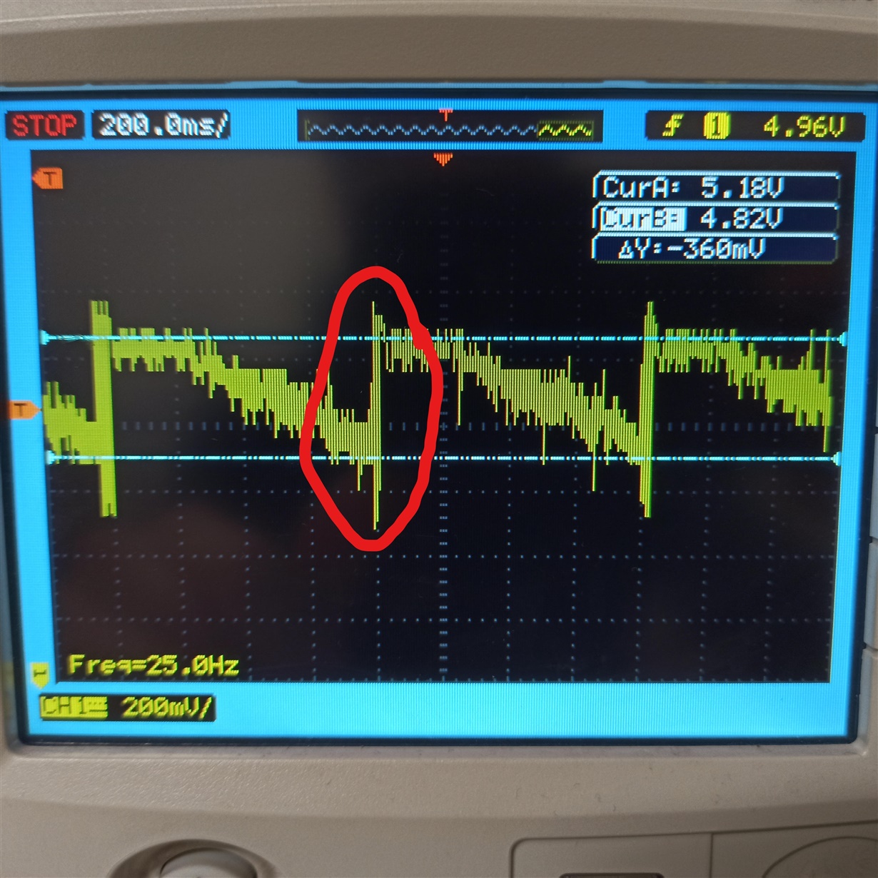

    • I tried with different power sources and cables: 1.5m USB cable attached to the USB2.0 port of my PC; same USB cable attached to a switching adapter with output power of 10W (2A); switching adapter with fixed cable (with terminal USB connector) of 1m and output power of 12.5W (2.5A). On the previous prototype board (good board) there weren't any issue with all of the abovementioned sources. However, on the current prototype board (bad board) I'm observing different behaviours depending on the used source; the worst behaviour is given from the switching adapter with the highest output power (2.5A); here's what i'm observing on VBUS with the oscilloscope:
    Slow decay (25Hz) of the VBUS voltage from ca. 5V to less than 4.8V

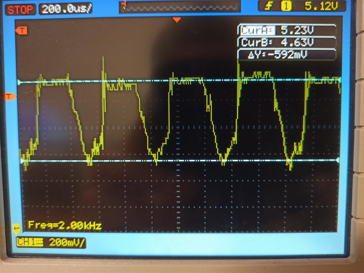

    Here's the detail circled in red in the previous image; there are higher frequency oscillations (2KHz) approximately in the same voltage range

  • Hi Alessandro,
    I suggest lowering the charge current and lowering the input current limit.  The input current limit should not be set higher than the input source can provide.  Adding more capacitance on VBUS might help but adding more capacitance on SYS or BAT will likely make the problem worse.

    Could you please also confirm that the other modifications I've applied to the current prototype board will not constitute any problem?
    Thank you again. Kind regards.
  • Hi Alessandro,
    Leaving STAT and PG floating is okay.
    If OTG is pulled low through the resistor, OTG is disabled.  If you pull the uC pin high, OTG would be enabled assuming the requirements at the bottom of d/s page 16 are met.
