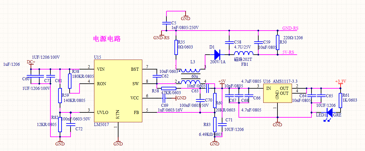

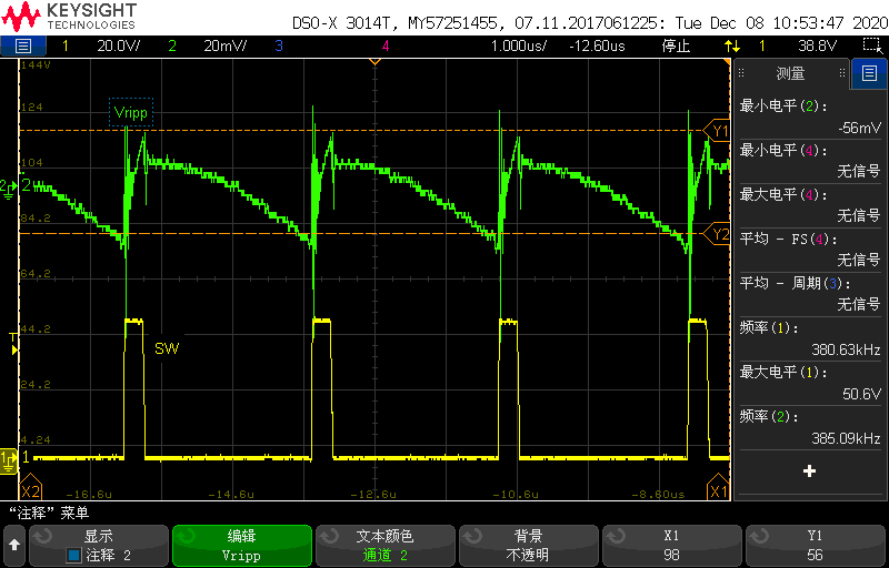

when using LM5017 as below circuit, i found the FB pin ripple has a big spike during ON time pulse. Is there any method to reduce such spike?
the fsw is around 380kHz, the output capicitor is ceramic Capacitor 10uF with around 20-30 mohm.

Hi Gene,
Lower value ceramic capacitors are effective at reducing high frequency ripple. Try placing an additional 1uF and 100nF capacitor at the output.
Also, when measuring the ripple voltage, make sure to use a very short, close-coupled ground for your probe. The inductance of a long scope ground wire will show up as high frequency noise.

The capacitors placed could be enough. I'm not sure of the placement of these caps. Have them try measuring the ripple across the capacitors using a tight, close-coupled ground lead of the scope.
