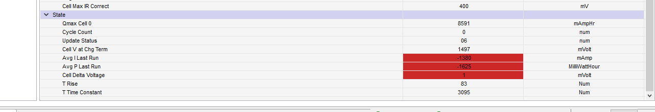

  • Hi Yevgen,
    After a few more days tests, I found the issue is still not resolved even with gauge connected permanently. With the golden image file from GPC calculator, it is only good for one continuous discharging cycle.
    I stopped the discharge process when SOC is at around 20%, then I waited there for about one hour until the OCVTAKEN bit is set. The FCC and True RC jump around again like before. SOC jumps from 20% to 48% (line11218).
    Then I continued to discharge the battery until empty, and wait for another hour until OCVTAKEN bit is set. Now the FCC drops and True RC goes to negative again (line 12861), the result is same to what I have done before using the cycle learning process. The FCC and True RC start dropping since line 11476 when voltage is at 24.2V, because it was popping up from 20% to 48%.
    At the end of discharging cycle. I realized that the AVG I Last Run and AVG P Last Run are updated from -299, -1131 to -1380, -1625, respectively. Even though the values in Ra Table are updated as well, it seems they are not affecting the FCC and true RC that much. If I changed AVG I and AVG P back to -299 and -1131, then disconnected and reconnected the gauge from the battery, the FCC and True RC goes back to values that seems to be correct. And it becomes incorrect values again if I changed them to -1380, -1625, which are the actual average current and power run from last discharge cycle.
    I am trying to change the learn status from 6 to 2 to prevent updating the QMAX and Ra values, even though it doesn't seem to be right approach for our application to disable the Ra and Qmax learning, but I guess it still cannot stop changing of AVG I and AVG P.
    I also tried to modify the values AVG I Last Run and AVG P Last Run on gg file and resubmit the package to GPC calculator tool, however, it seems these two parameters are not affecting Ra values. The GPC calculator tool might have some issues since last evening, because it keeps rearranging the texts on the top few lines in the GG report file.
    Please help me out.
    Charles
    Logging Jan 26.xlsx
  • From the above data there are not indications that Ra and Qmax are abnormal, so I would not try to prevent their
    update.
    Also the value of current that is learned is correct, according to your discharge rate. In any case, you do have an option to make value used for simulation of RemCap and FCC fixed - you can set Load Select = 6 (custom), Load Mode = 0, and set User Rate mA to desired value, for example -299mA.
    The only value that is not updated and could contribute in too strong effect of current on RemCap and FCC are the thermal modeling parameters.
    Temp_k and Temp_a. If data summited to the tool did not have temperature correctly measured on the surface of the cells, temp_k might be incorrect. You can for testing try to increase it by 5x, and see if this will prevent RemCap and FCC from becoming too small.
    If that is the case I would re-collect the data at the same rate you are using for the testing, so temperature increase is significant to update temp_k and temp_a parameters, and after making sure thermistor is connected to the cells.
    Yevgen

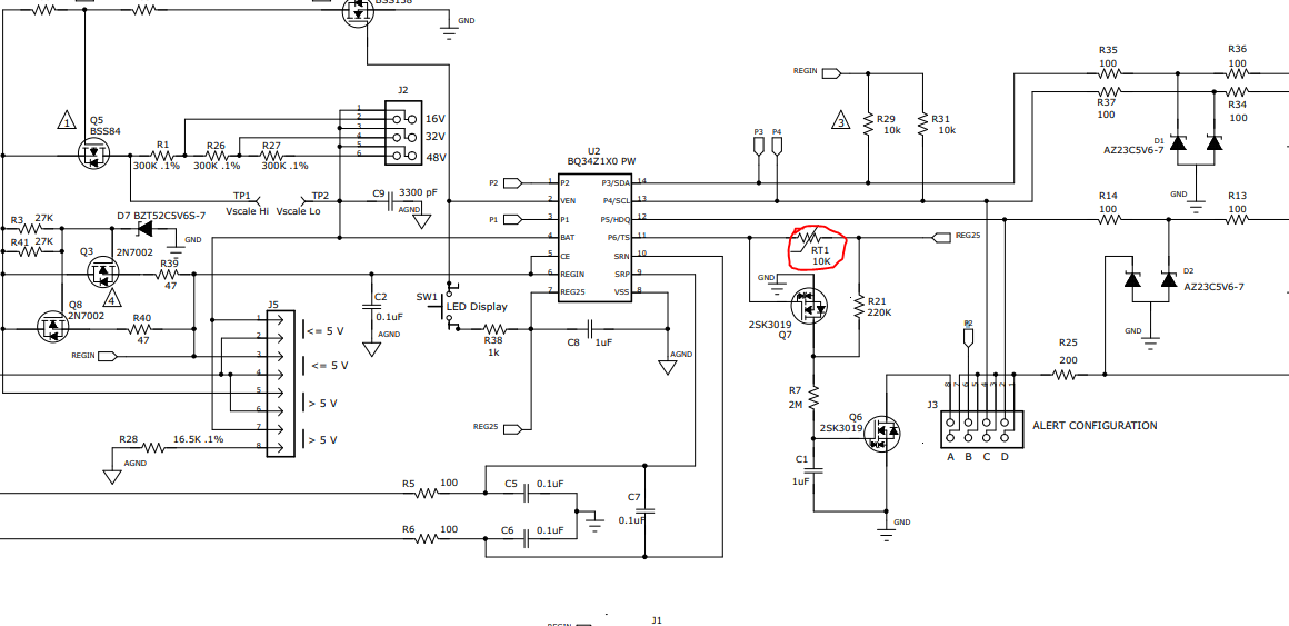

  • Hi Yevgen,
    I guess the thermal modeling parameters have high possibility to cause the issues. Our battery is well packed, so there is no way to measure the cell temperature, there is an NTC wire from the internal of the battery, but I didn't connect it to anything. Also, I cannot find the temp_k and temp_a parameters on the data memory. Are you referring some parameters in the Ra table? Sorry, I am not familiar with the thermal part parameters, I could not find much information in the datasheet.
    The board I am using is BQ34Z100EVM, which has one thermal sensor, I guess the user has to put the battery cell very closed to this sensor to get accurate temperature. In our case, where should I connect the NTC wire on the board. Should I remove that 103AT-2 thermistor and connect it directly to pin P6/TS?
    Best Regard,
    Charles
  • Hello Charles,
    I would not recommend using the thermistor in the pack because it most likely has different characteristics from the semitc 103AT we recommend.
    You should extend the wires for the thermistor to the pack.
    Sincerely,
    Wyatt Keller
  • Hi Wyatt,
    Do you know the Temp_k and Temp_a parameters Yevgen mentioned? I could not find them in the data memory of BQ34Z100 chip, I would like to have a test by changing these values as per Yevgen suggested.
    Charles
  • Hi Wyatt,
    I understand that the thermistor probably is different from semitc 103AT, however, the battery we are using have battery cells well isolated from outside environment. I could not put another thermistor inside the battery. I just would like to try to see if it works, if it doesn't, we would need to switch to another monitoring chip.
    In the datasheet, it states that "When an external thermistor is used, REG25 (pin 7) is used to bias the thermistor and TS (pin 11) is used to measure the thermistor voltage (a pull-down circuit is implemented inside the device). The device then correlates the voltage to temperature, assuming the thermistor is a Semitec 103AT or similar device."  I am wondering if I connect one NTC wire to the TS pin, what should I do for the REG25 pin? leave it floating?
    Charles
