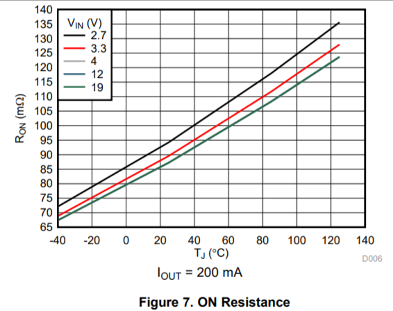

Hi support team,

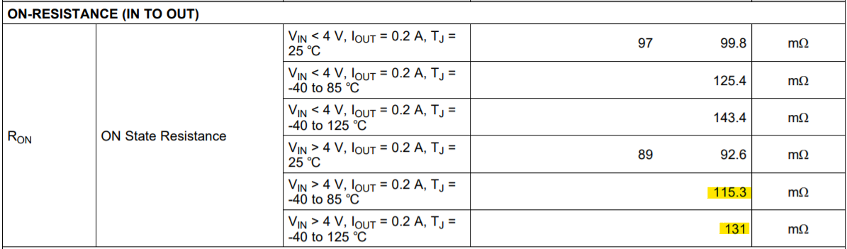

The ON-Resistance value is written on SLVSET8A.
- RON, Electrical Characteristics, Page-7
- Figure-7, Page-10
Only data with IOUT = 0.2A.
Does the ON-Resistance depend on VIN and TJ and not on IOUT?
Are the RON values with IOUT of 0.125A to 2A equivalent?
The input voltage is 5V.
Dice-K
  • Hi Dice,
    Ron varies with VIN and Junction temperature. From figure 7 of datasheet you can observe that,
    • For Vin < 4V Ron reduces with increase in Vin. For Vin > 4V the Ron is almost independent of Vin.
    • As junction temperature increases the Ron increases.
    There is no much variation of Ron with load current. You can  consider it as constant across load current.
    For your application , 5V and load current = 0.125 A - 2A you can consider the Max Ron to be
    • = 115.3 mohms for Tj = -40C to 85C
    • = 131 mohms for Tj = -40C to 125C
