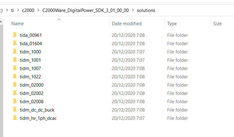

Where i can find source code TIDA-010039 Three-level, three-phase SiC AC-to-DC converter reference design i have install Ti C2000 Digital Power SDK and still cannot find the folder for TIDA-010039
Thank you
BR
Abdin
TIDA-010039 is still not a part of Digital power SDK and will be available in April 2021.
If you want to download a pre- release version of the software which is slightly different from the final SDK, you can request for the same in
under software development
Thank you

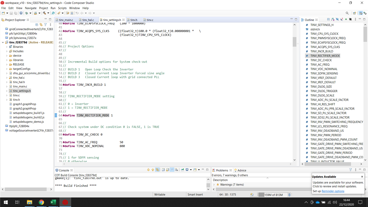

As we know the hardware not ready for sale and i have not build the 10kW AC DC or DC AC yet, i just have TMS28379D Launchpad, i have compile and get no error, i found that in tinv_setting.h mentioned it could be act as inverter and rectifier.
this TIDA very insteresting, i will start to make emulation in the sotware, i will generate my on sine voltage and current inside MCU lets see the algorithm will catch it.
I think this is solved and wait for final software release
Thank you
