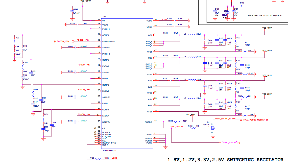

 We are facing issue that output voltage is 0V in all four outputs.
We float the I2C interface and expecting the output through hardware configuration.
Also confirm that regulator require initial program.
Voltage at EN pin is 2.1V.
Please review the schematics attached.
