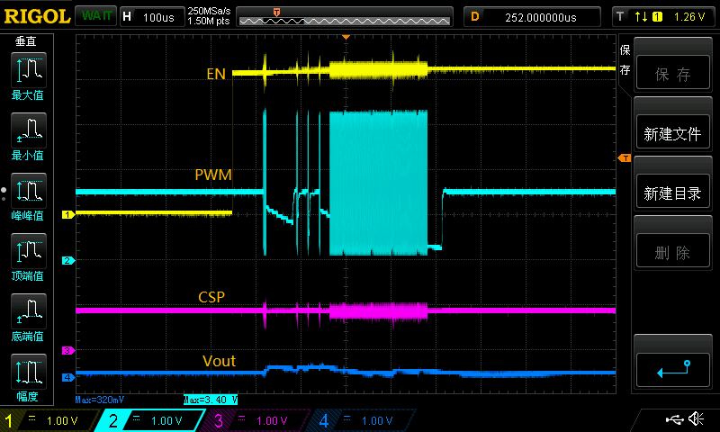

TPS53647: VR fault fired after ENABLE the chip without load
Part Number: TPS53647
HI,

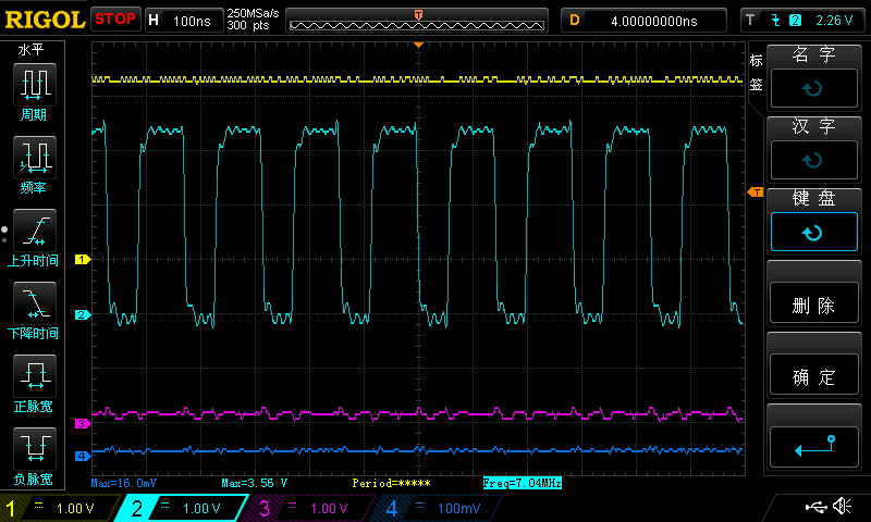

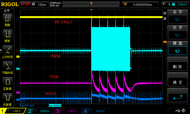

We designed a TPS53647 multiple phase buck board based on the schematic given in the datasheet. With no load connected, after ENABLE the chip, we got the OTP fault (Both the register and the VR_FAULT pin report it).  It seems this is the same situation with one previous post .
Any help?
Thanks.
