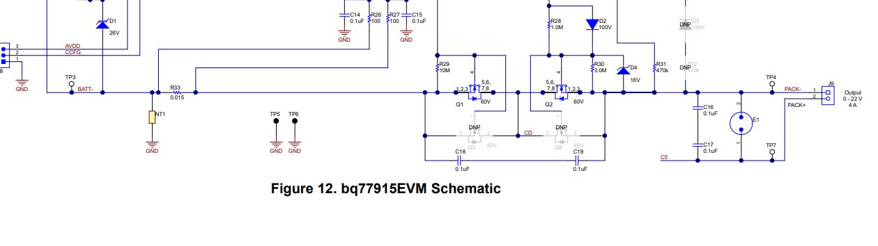

All the features of My 10S BMS with two bq77915 devices are working well except for short circuit protection. When PACK+ and PACK- are shorted, DSG MOSFET is burnt. I believe that DSG MOSFET is not being tuned off quick enough. Data sheet shows R_DSG resistor should be adjusted to to set desired rise and fall time. My little experience tells me to reduce R_GS_DSG resistor ( because if this resistor is small gate capacitance can be drained quickly so MOSFET will turn off) am i right?. Which process makes discharge MOSFET turnoff Faster.

    1.I wonder what is the use of C18 and C19 in the EVM schematic? Will they help in protecting FETs?
    2. I would like to follow trial and error technique, use the values of 2k, 2.5k, 3k,3.5k, 4k for R_dsg.. is this OK? or should I Play with Rgs_dsg.

    1. C18 and C19 are for ESD bypass of the FETs.  These small capacitors provide high frequency AC short across the FETs while for DC the path may be open if the FETs are off.  2 caps are used in series in case one shorts, the other may still be ok.  One component fault will not bypass the FETs, it takes 2 faults, one on each cap to bypass the FETs.
    2.  The BQ77915 has a low turn off resistance RDSGOFF for DSG.  This resistance acts with an external series resistor to the FET gate to discharge the FET gate capacitance and turn off the FET.  Testing various resistors is a good idea.  With a single FET I would expect values toward the larger end of your range or bigger, but there are many factors in a system design. I expect you would want to vary your equivalent of R23 in the EVM design, R_dsg.  Rgs_dsg (R29 above) will provide a DC load when the DSG FET is on.  It is normally a large value.
