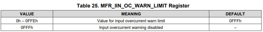

Dear expert,
We set the the input over-current warning threshold as 7.5A, and 0xD8 IIN LIMIT Warn Alert Mask=0 vis GUI. We found the 0xE1 IIN_OP_WARN=1 when the input current  rises above the threshold value. But the SMBA/ was still high. Is it normal?
Does the input over-current warning  make the SMBA/ low?
