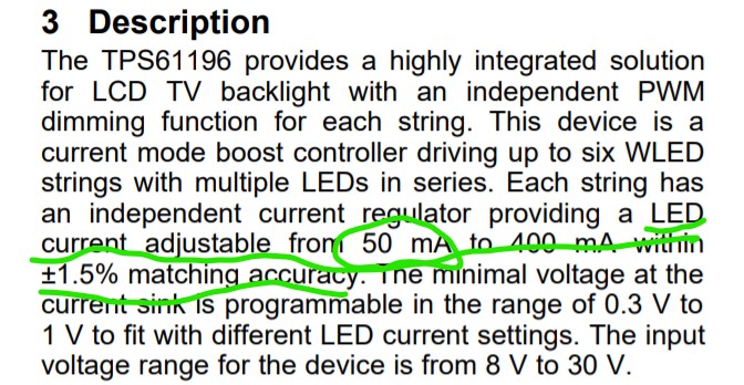

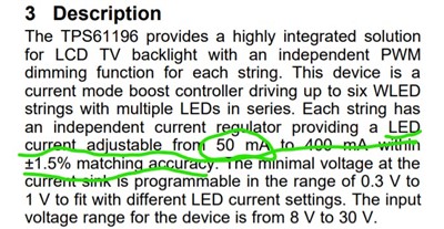

Hi team,

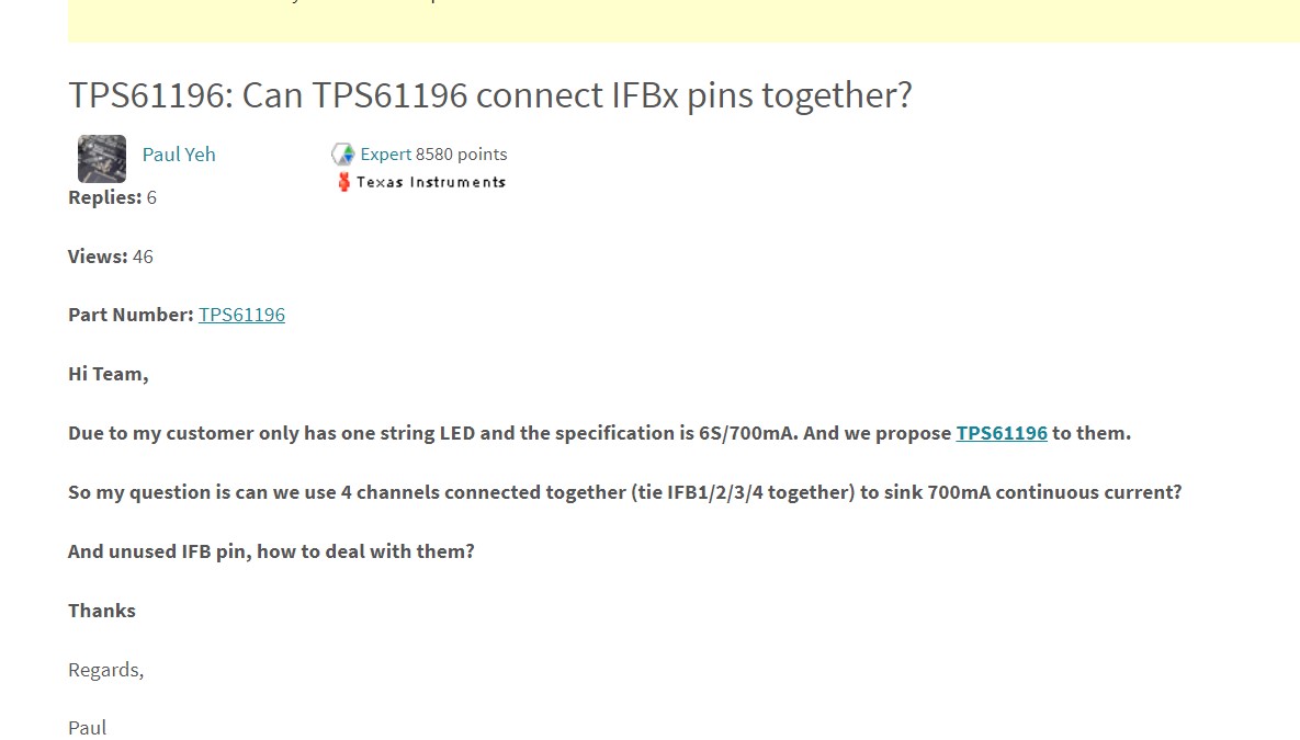

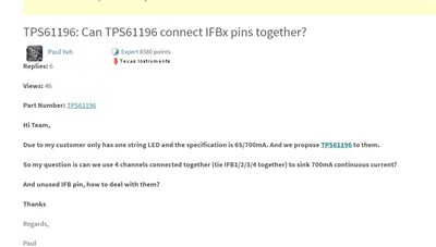

This is related the same question- I captured portion content for reminder.
There is two ILED current level, low level is 90mA and high level is 1.2A. And they connect 6 IFBx together.
After calculating, each IFBx will be 15mA(min) and 200mA(max).
But there is statement in datasheet that adjustable current range 50mA to 400mA.
And we also find if IFB current setting is lower than 50mA then device didn't enable.
Please advise can this device use lower ILED current <50mA? Or how to do?
