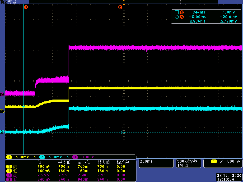

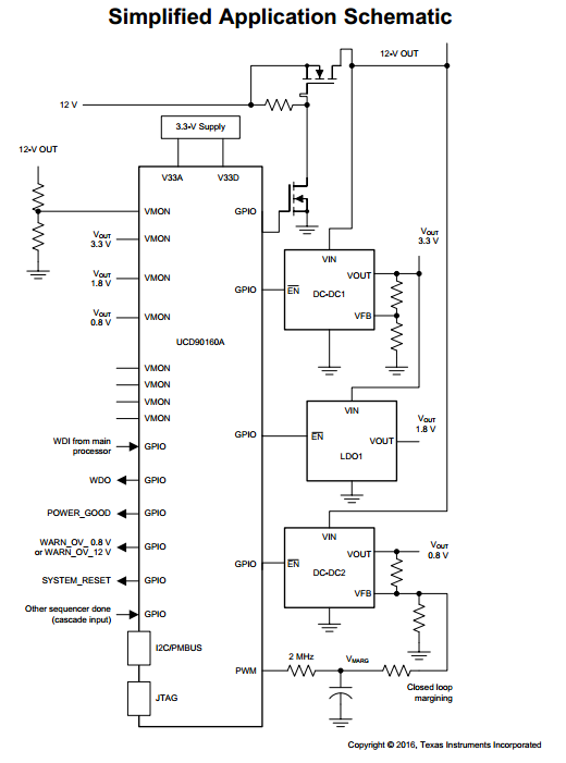

we measured UCD90160A input power and output GPIO(for DCDC BUCK enable), detect CH2 GPIO voltage 780mV,  is similar with CH1 VCC3V3 voltage value;
GPIO electric leakage will lead to mainboard DCDC chip enable ,  voltage output rise edge have "the stage";
datasheet can't find with V33A/V33D the logic relationship between GPIO, please help to solution, Thanks!
CH1: UCD9016_3V3(Pin 7 44~46)
CH2: VEN_CPLD_VDD1P8(Pin 14 GPIO4)
CH3: PSU_PWR_OK

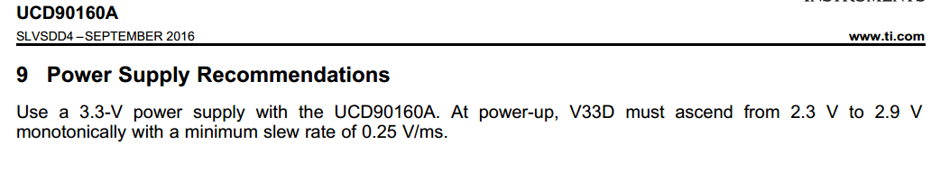

    What is the pin for the PSU_POWER_OK? You may try to increase the slew rate of the V33D.
    -->so, GPIO pin arise electric leakage condition when slew rate of the V33D too low?
         exp. V33D voltage value only 780mV, chip not working, chip[ GPIO pin will keep unkown state?
  • HI
    Why was the V33D has a very slow ramp up at the very beginning and then suddenly rise? This is not a typical power ramp up.

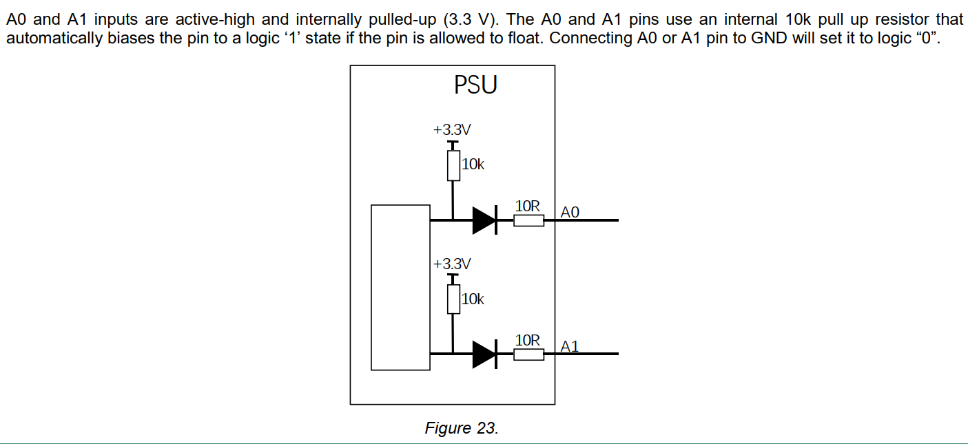

  • Hi yihe:
    --> PSU address pin has internal 3.3V pull-up ,this voltage will pass by PWR board pull-up resister electric leakage V33D,;
    so , we will remove  PWR board pull-up resister , it's resolved this issue;
