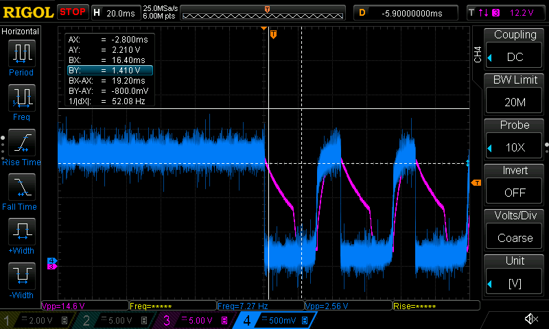

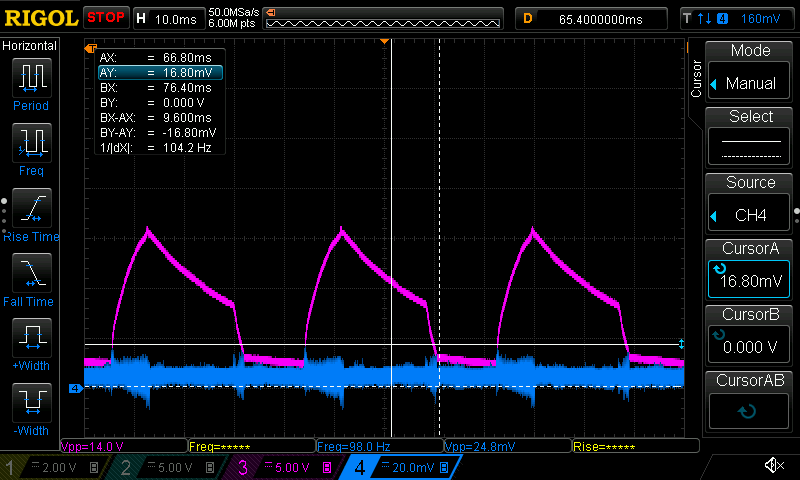

Hi.

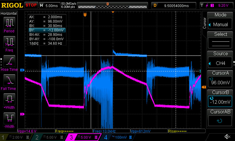

When I tested new PCB with LM5176 a serious problem was discovered in the operation when Vout in range about Vin...(Vin+2V).
I chose this device precisely because of the declared ability to work when the input voltage close to output volatge. I expected that in this mode there will be an increase in ripple, but not a complete failure of the device.
The device continuously shuts down due to activation hiccup mode.

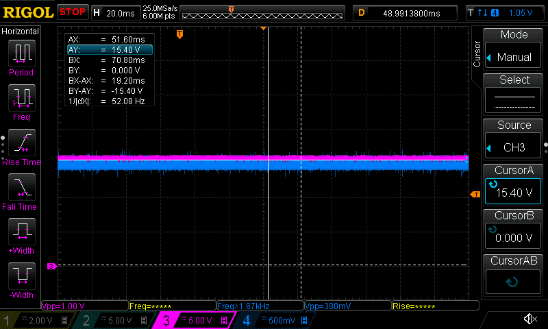

I checked that there are not overvoltage on Feedback and voltage drops on Enable pins.
Chart1. Blue - FB , Pink - Output

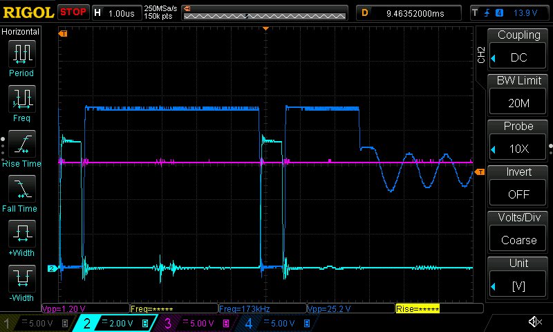

Chart2. Blue - Enable pin, Pink - Output

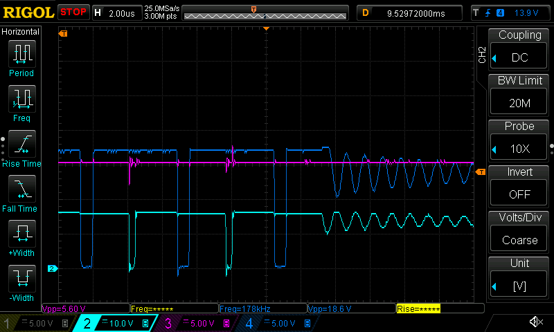

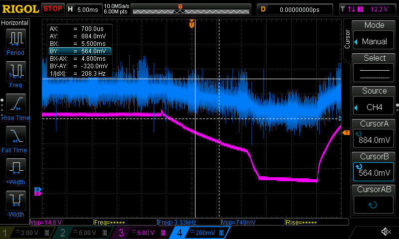

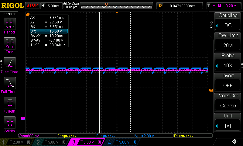

Then I checked stabilization on inductivity and transistors gates.
Chart3. Pink - Output voltage; Dark blue - Inductivity from VT 5/6/7/8 (Buck transistors); Light blue - Inductivity from VT9/10/11/12 (Boost transistor)

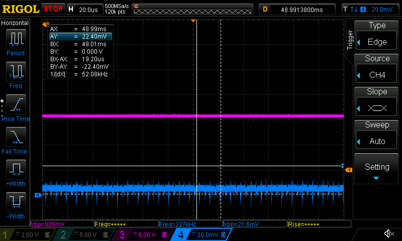

Chart4. Chart 3 in zoom

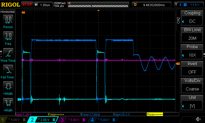

Chart5. Dark Blue - VT5/7 Gates (High side buck transistors);  Light blue - VT6/6 Gates (Low side buck transistors)
Chart6. Dark Blue - VT5/7 Gates (High side buck transistors);  Light blue - VT9/11 Gates (High side boost transistors); Yellow - VT10/11 Gates (Low side boost transistors)
The are high spikes on the charts due to the long ground wire (I can't put more than one probe with special short ground spring and press buttons on the oscilloscope in the same time)
It is obvious that the device simultaneously tries to work in both busk and boost modes. Maybe it is normal operation for LM5176 but I don't see other reason for hiccup but simmultaneous opening High side buck transistors and Low side boost transistors.
There is only about 100 Ohm resistive load connected to output. Beyond this region device starts works correctly with the absence of any signs of overcurrent hiccups or uneven stabilization in both buck and boost modes.

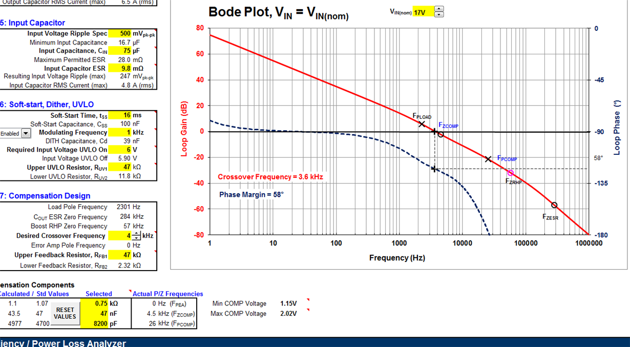

    QuickStart calculator shows that selected compensation network is fine for all variants output voltage (Phase margin never drops under 40°). Moreover this is not some difficult mode of operation near device limits. I just try to achieve Vout=16V at Vin~16...17V with load of 100 Ohm.
    Equivalent input and output capacitance was calculated according to murata article taking into account ceramic capacitors dc bias in worst case 48V input voltage on frequency 200kHz. ( https://www.power-mag.com/pdf/feature_pdf/1387888355_Murata_Feature_Layout_1.pdf

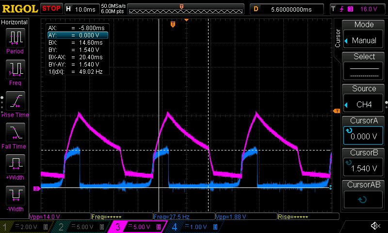

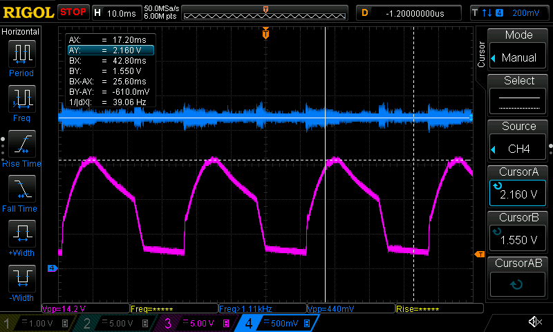

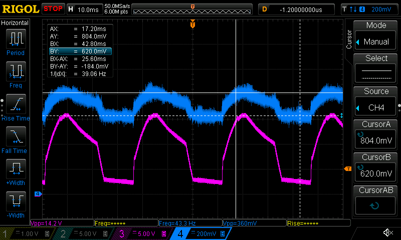

    >1. Please reduce the current sense resistor to GND by a factor of 2 and check if the problem is gone. On the other hand you could as well first measure the CS voltage.
    I replaced all components in CS Amplifier network including RC filter than I checked problem again and reduced current sense resistors by factor of 2 (All resistors is WSL25129L000FEA18). The problem was not fixed.

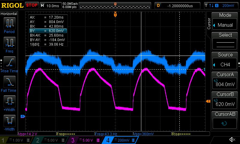

    I measured the voltage on CS and CGS pins on filter capacitor leads and did not see condition indicating overcurrent. But there is very strange behaviour or Comp pin - there is strong forced pull down when hiccup starts.
    Voltage on CS pin + Vout
    Vout + Vcomp

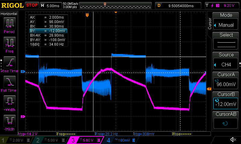

    > 2. What happens if you disable hiccup mode and operate the device in buck mode and then slowly reduce the VIN. If possible measure CS voltage during this test.
    There was stable output voltage with Vin at, below and above Vout. As expected all charts looks fine.
    Vout + Voltage on CS PIN
    Vcomp + Vout

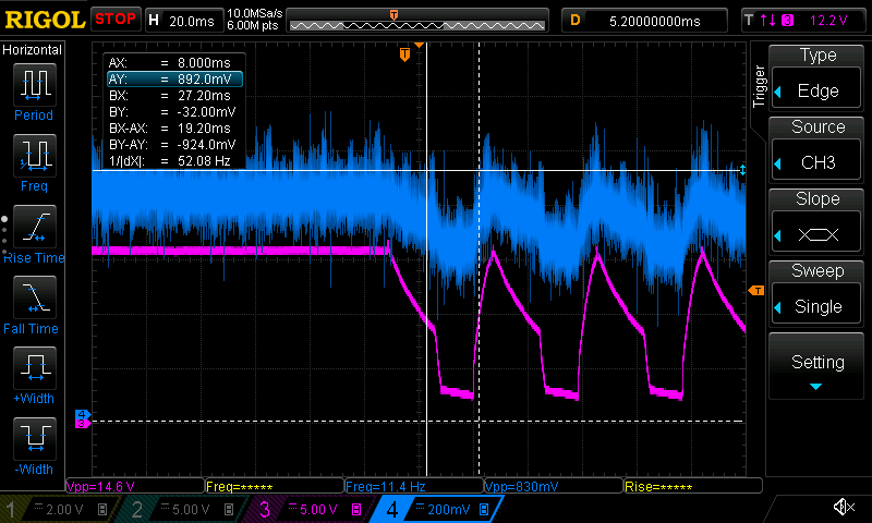

    3. I tried to catch overcurrent on CS pin with oscilloscope on trigger mode with hiccup mode enabled. Then I checked what is happening in the moment when controller break regulation but again I didn't see anything new but strong pull down at Comp pin.
    Vout +Vfb
    Vout + Voltage on CS pin
    Vout + Vcomp
    If i think in the right direction then only slow current sense amplifier can do this things with Comp voltage by reducing Voltage at SS pin.
    I will check Voltage at SS and ISNS+/- pins as soon as I will be able to interact with the PCB board. But it still unclear why in this case this happens only in the region when Vout <= Vin...Vin+2V and only when hiccup mode is enabled.

  • I made some new tests.
    Shorting output of slow current sense amplifier inputs at Filter capacitor leads didn't fix problem.
    I again carefully checked if I had a short circuit from simultaneously open transistors, observing their gates, and did not see any.
    For now the problem is solved by installing a 1000pF capacitor in the fast current sense amplifier filter circuit. It seems that it have too fast response for high frequency noise that increase when two modes starts work simulteniously. There will be some extra current limit offset during operation so I will try to reduce it a little. Is you have any opinion on this situation ?
