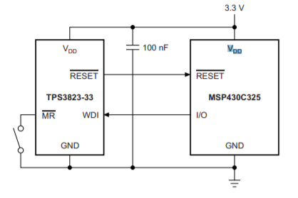

Hi team,
My customer found that the reset signal's rise time of TPS3823-33DBVR is quite long, about 1.1us, cannot meet their processor's requirement.
Their processor requires that rise time of reset signal must be less than 300ns.
Could you recommend another suitable part to meet the processor rise time requirement?
