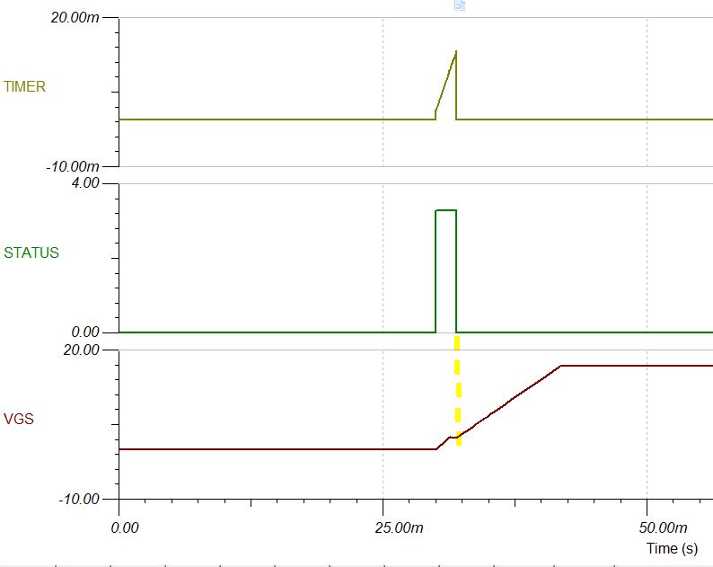

2)The design was simulated using TINA TI simulation model. In the GATE pin, a resistor 4.75ohm and 100nF capacitor is connected (refer image below). The timer capacitor used is 68nF. While startup, the 100nF capacitor is preventing the VGS to ramp up quickly before timer capacitor. Hence MOSFET was turned off. When 100nF was changed to 10nF, the fault timer discharged when the MOSFET ramps up from the voltage (which seems like a plateau voltage since it stays on the same voltage for some time - 2.35V). In the datasheet, 5V is given as threshold. But for us, the fault timer is discharged at 2.35V(Refer Image below). Please clarify this.

    2A) Can you please share your TINA file to look at
