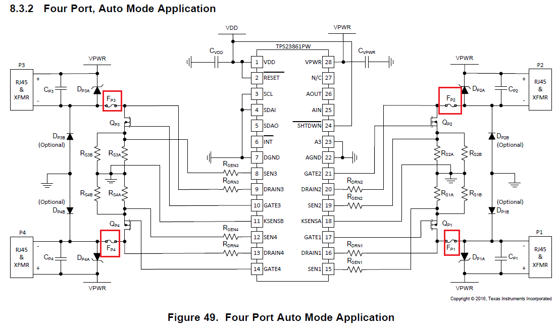

Hi Team
I'm planning to design the schematic following Figure. 49 in the datasheet, but I don't want to reserve the fuses.
How should I set the overcurrent condition if I2C connected to the ground as like Figure 49?

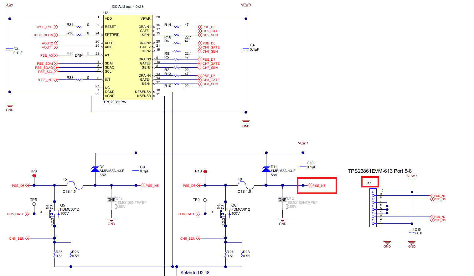

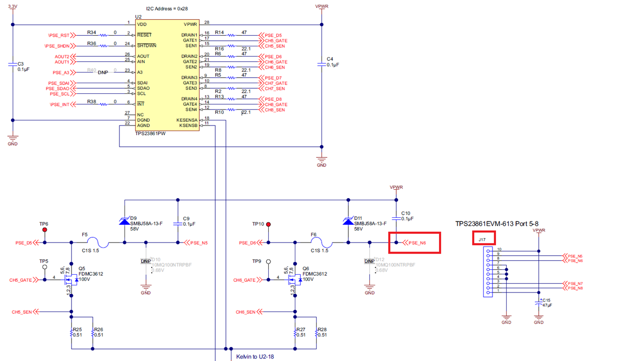

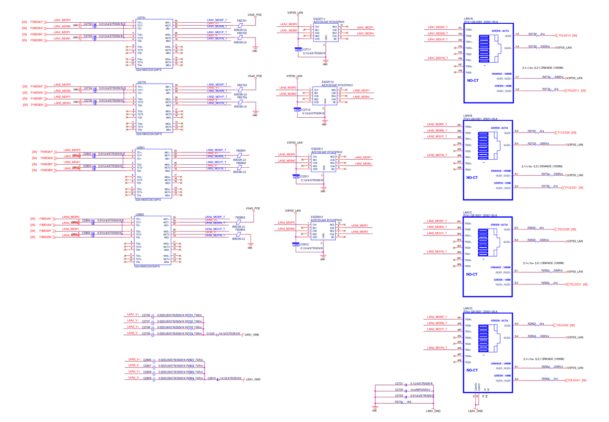

  • Hi Team
    I'm not sure what the function of J17 in the reference design of TPS23861EVM-612 is.

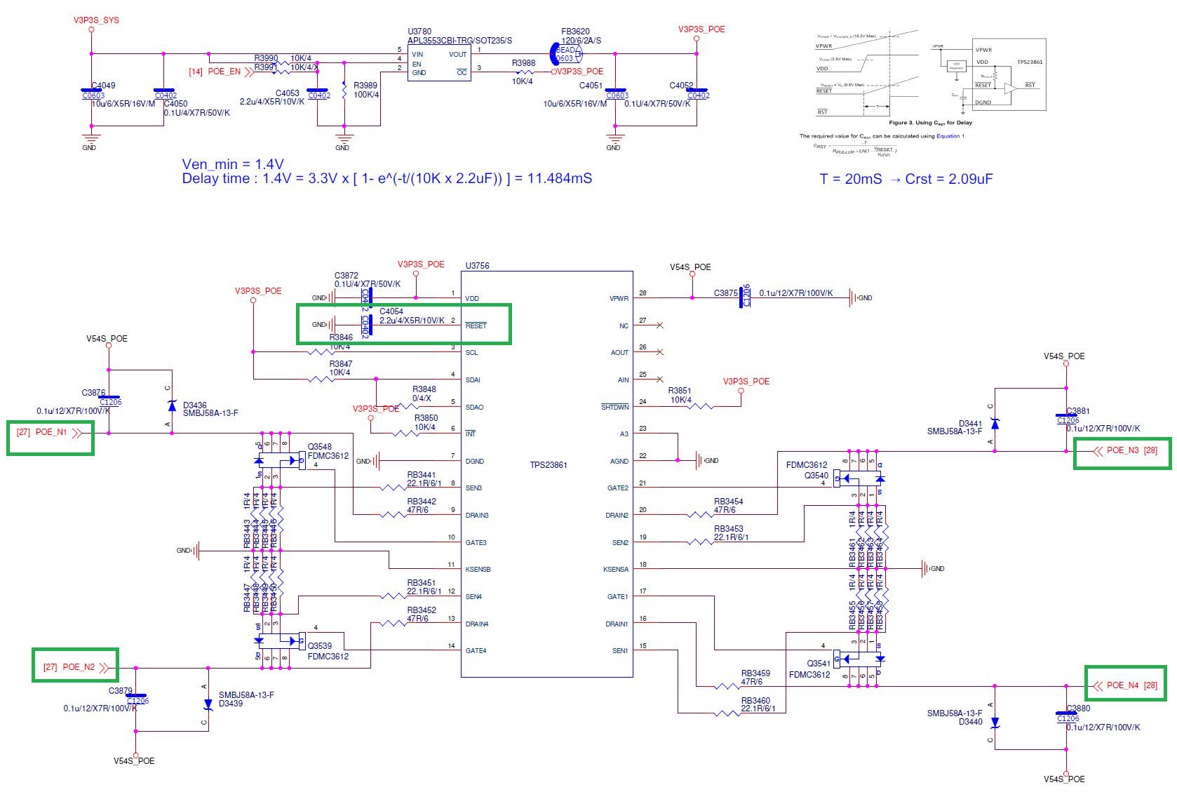

    Just attach my schematic. Please also help me confirm it, thanks.
  • Hi Jerry, sorry for the delay as we're back from winter holiday. J17 is just header of the motherboard. Majority of PSEs will use a motherboard/daughtercard approach. It allows for a 4layer motherboard (RJ45, data transformer etc, microcontroller) since it is part of the total system PSE hardware, and a 2layer daughter card for a lower total system cost. This also allows flexibility from using 2 pair or 4 pair PSE controllers by switching out the daughtercard without re-laying out the PCB.
    A couple of comments regarding the schematic:
    At the data transformer for each of the pairs, the return path should not connect to GND but rather the drain of the PSE pass FET. Please see the EVM as an example. Otherwise, the voltage on the port will always be 54V and no PoE handshake would occur.
    Also please make sure for the power sequence, that VPWR powers up before VDD. This is required per the datasheet. You can also use the EVM as an example.
    Thanks!
  • For the question regarding the fuses, the fuse is NOT a required component for the PSE to function correctly. It is more a system level option for added protection and to get UL certified without validation testing.
    For the overcurrent question, since the TPS23861 is operating in automode, and not using I2C, the PSE will automatically adjust its overcurrent threshold based on the negotiated power of the PD. So if a Type 1 PD is connected, the PSE will protect itself when the power reaches over 15W.
    Thanks!
  • Hi Darwiin
    Thanks for your response.

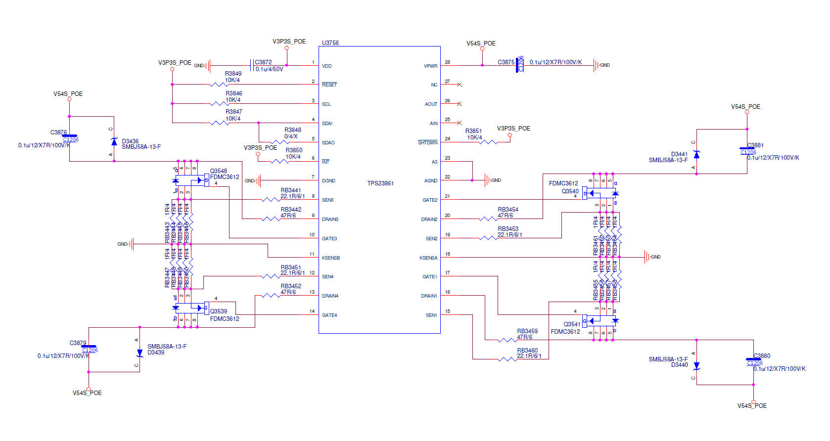

    I revise my schematic following your suggestion. Please kindly help me confirm whether I comprehend what you said.
    In addition, how should I handle with I2C(SCL/SDAI pin) to confirm that  TPS23861 is operating in automode properly? Pull to VCC/GND or left floating?
  • Hi Jerry, the schematic looks okay to me. For the I2C we use the below reference design in automode as well. We pulled SDAI and SCL LOW, then kept SDAO floating. Thanks!
