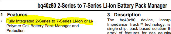

    The bq40z80 doesn't support 7S system anymore. This is one of the issues that occurs randomly with 7S systems, you will need to use a top of stack gauge like bq34z100 with a monitor.

    The bq40z80 was changed for only 6S support because of similar issues. I will have to check our timeline for releasing new FW that may help with some of the issues, but it will still not be rated for 7S.

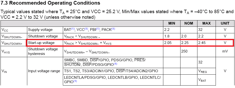

  • Hi  Keller,
          Can the new firmware solve the problem of not being able to wake up after shutting down?
          When will the new firmware be released?
          We can accept the inaccuracy of the 7S voltage.
           In order to solve the problem of not being able to wake up after shutdown, we tried to reduce the shutdown voltage from 2.75V to 2.3V. It seems that it can wake up at 2.3V. Is this a good solution?
    The timeline is sometime in the first or second quarter 2021, this is not confirmed though.
    It sounds like your shutdown voltage threshold was set too high, reducing the threshold can help make it easier.

    The bq40z80 will not be re-specified for 7S support after the FW release. It will only help fix the existing issues with it's operation in 7S configuration.
