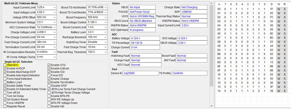

I'm working with the BQ25895EVM-464 board and the EV2400 interface board (firmware v. 0.18), BQSTUDIO v1.3.101 on a Win10 64 bit machine.
Communication with the evaluation board seems ok but I can not understand why the parameters on the registry is changed when the /CE pin is switched.
Actually I'm working with a little LiPo battery (420 mAh but able to give in discharge up to 15C) so I've set a fast charging current equal to 384 mA (REG04), precharge current and end-charge current are set to 64 mA (REG05), the minimum settings available inside BQSTUDIO and from BQ25895 datasheet.
The Input Current Limit is set by the registry to 3.25A (REG00) and the R19 trimmer on the evaluation board was tuned to achieve 0 ohm, so the only effective resistace on the ILIM pin is given practically only by R1=130R so the value of the maximum input current set by the limiting resistor is equal to IINMAX=390/130=3 A (suppose KLIM_max=390).
The idea is keep the /CE pin high, write the parameters on the board and the force a low level on the /CE pin to enable the charging of the battery avoiding then a too high charging current that is set from the default register value...
But when I perform the registry write and then I manually read back the registers content the value seems not updated and equal to the default values though the Device ACK into the BQSTUDIO is OK hence I think there are no communication errors with the device (the EV2400 I2C Clock Speed is set to Low Speed 100 kHz).
I've attached my registry settings for your reference.
Thanks and best regards.
F.
Register settings

  • UPDATE #1
    I've shorted DP with DN on the BQ25895EVM-464 board, to do that I've removed the jumper from JP3 and put it on JP5.
    Now the registry setting value are retained.

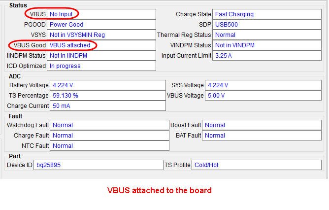

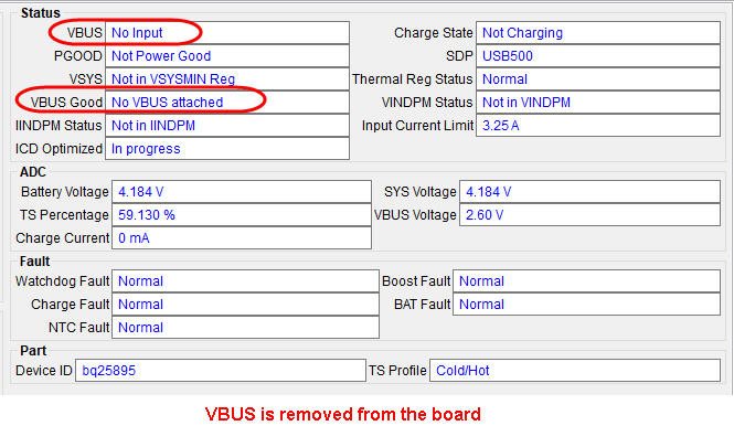

    Another question is about the Status window (Field View), when the VBUS is applied I can see inside the Input Current Limit textbox 500 mA, when the VBUS is removed the text change into 3.25A but with the selected settings the Input Current Limit should be always fixed to 3.25 A? Why this value change?
    To solve the Input Current Limit I've removed the check on the Enable Auto-Input Detection checkbox, now the VBUS report aways the string OTG, voltage on PMIS is 5V and the boost mode is activated 30 ms after the VBUS is removed as stated into the datasheet.
    ISSUE ABOUT VBUS label on BQSTUDIO
    In my application I'm not using the PMID output so I've disabled this feature by pulling down the OTG pin through the JP6 jumper, now when the VBUS is not applied at PMID I've the battery voltage, instead the 5V from the boost (and cyclically I can see a little drop long 75 ms on the PMID voltage, measured with the battery in fast charging stage), but in BQSTUDIO into the VBUS textbox I can read "No input" everytime even if the VBUS is applied.
    In order to understand when the VBUS is present or not I can see that inside the "VBUS Good" text box I've "VBUS attached" or "No VBUS attached" so I can use the bit 7 of the REG11 to understand when the VBUS is present or not, but the question is if the "No Input" text field is a BQSTUDIO issue or I've to perform some more checking or change other options.
    I've attached two screenshots when VBUS is attached and also removed.
    F.
  • F,
    What is REG02 value when VBUS shows "No input" and "VBUS attached"?
    Ning.
  • Dear Ning here below the requested data:
    - VBUS not present
    REG02=7C / FC (I've enabled the ADC reading so the bit 7 CONV_START can be 0 or 1) => rewritten in binary form: X1111100 (where X can be 0 or 1)
    - VBUS present
    hence the REG02 do not change respect the VBUS.
    Here below the main BQSTUDIO screenshot when VBUS is not applied (first) and when is applied (last).
    F.

  • F.
    When AUTO_DPDM_EN (REG02[0]) is disabled, the Input Source Type Detection is bypassed. The Input Current Limit (IINLIM) register, VBUS_STAT, and SPD_STAT bits are unchanged from previous values.
    Referring to 8.2.2 Device Power Up from Battery without Input Source, If only battery is present and the voltage is above depletion threshold (VBAT_DPLZ), the BATFET turns on and connects battery to system. Referring to 8.2.6.3 Supplement Mode, BATFET turns off to exit Supplement Mode when the battery is below battery depletion threshold.
    Ning.
  • Dear Ning,
    thanks for your support!
    About the first point, when the Input Source Type Detection is bypassed, hence the only way to know if the VBUS is present or not is to check the bit 7 of the REG11, I'm right?

  • F,
    It is better to use VBUS_GD bit (REG11[7]) to check if valid VBUS is present.
    8.2.6.1 Narrow VDC Architecture on the d/s applies when valid VBUS is present.
    If only battery is present and the voltage is above depletion threshold (VBAT_DPLZ), the BATFET turns on and connects battery to system. VSYS is VBAT minus BATFET voltage drop. Please refer to 8.2.6.3 Supplement Mode Figure 12 on the d/s for the details.
